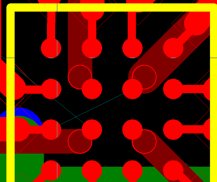

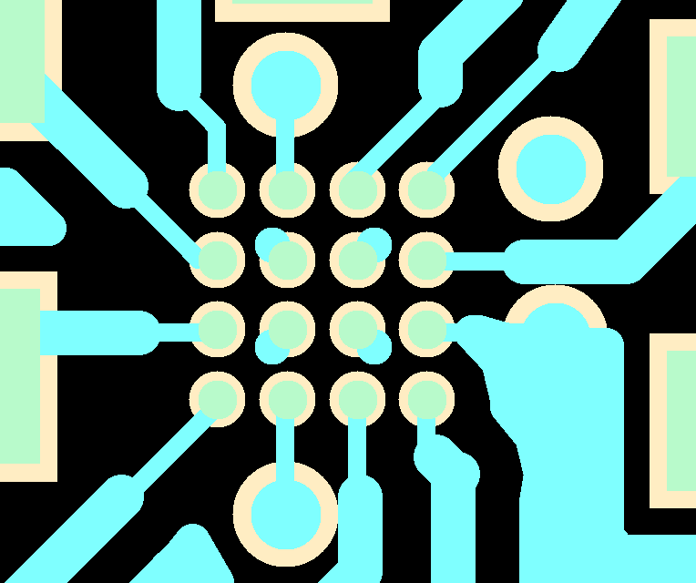

I have the STEVAL-CCA025V1 demoboard for the TS4621E part and looking at the gerber files for it it appears the inner balls of the package were routed by placing a via directly next to the ball pad but this would seem to violate the design guidelines in the datasheet for the part (which recommend a max 100um track from the pad).  I'd like to avoid using microvias due to cost and would thus like to receive some guidance concerning routing the inner balls of this package.
Here is a screenshot of the gerbers for the demoboard to show what I'm talking about:

I'm mainly wondering what was done on the demoboard http://www.st.com/web/en/catalog/tools/PF250873 as show in the posted image I gave.  It looks like they just put vias right next to the inner ball pads.  Is that a recommended procedure?

yes, it's recommended routing for inner balls fan out
since the solder pads diameter for BGA balls is around 0.25mm , then if we used buried micro via, the drill diameter will be much less than 0.25mm , and  processing cost will be increased as you mentioned before. if we shifted via posistion and just next the pads, it will be improved.
you could consider to use 0.3mm diameter via with 0.2mm drill hole  for inner ball soldering pads fanout.

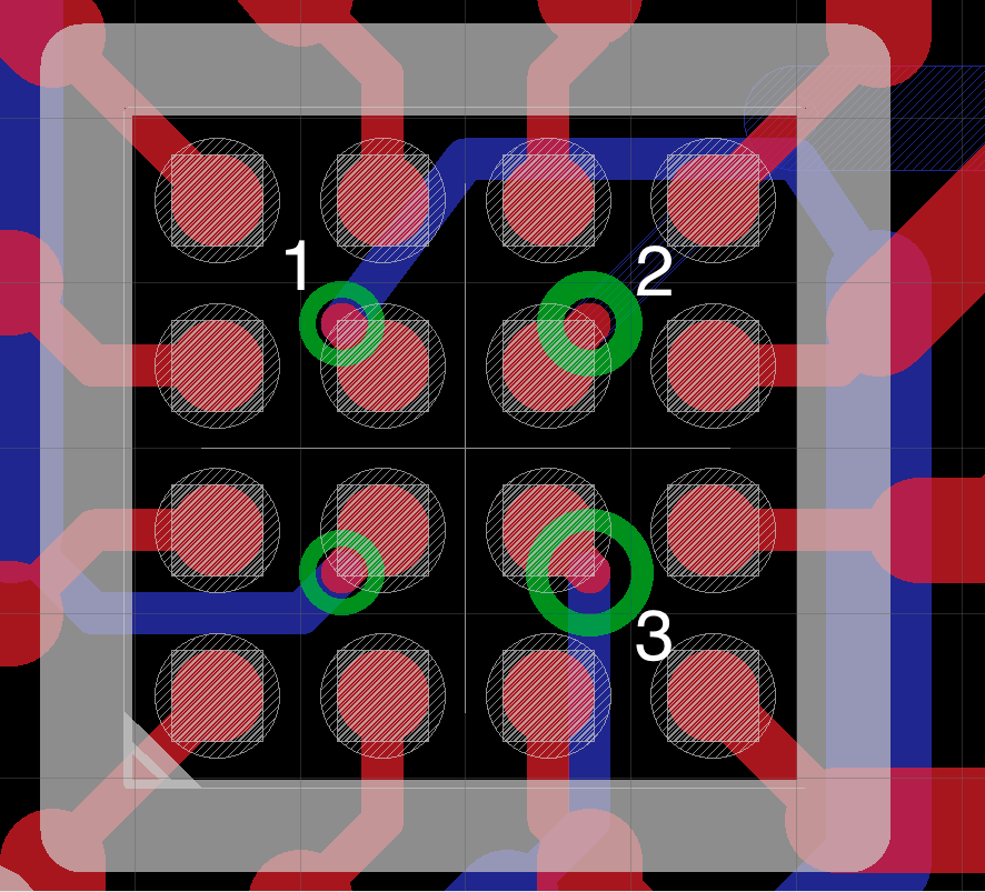

Hi, I finished the layout for this board and followed your recommendations for the breakout of the inner pads of the 400 um bga however I think they are too large.
If you look at the screenshot, number 3 is your recommendation, 8mil (.2mm) drill and 12mil via pad (.3mm).  As you can see this looks quite large as does the drill clip a good portion of the bga pad and the ring percentage is small.  Number 2 is a 5mil (.127mm) drill and 10mil (.254mm) via pad.  Number 1 is a 5mil (.127mm) drill and 8mil (.2mm) via pad.
Number 1 looks more like what is on your eval board however I worry about the annular ring being too small.  Number 2 was increasing the via pad size a bit.
Do you know in the eval board exactly what via pad and drill size is used?  Based on this picture do you have different recommendation?

yes , the via size will be large than pads for ball, below is snap shot of demo board layout.
for 5mils drill hole , if it's good balance between cost and reliabilty , you can use it in your PCB design .
