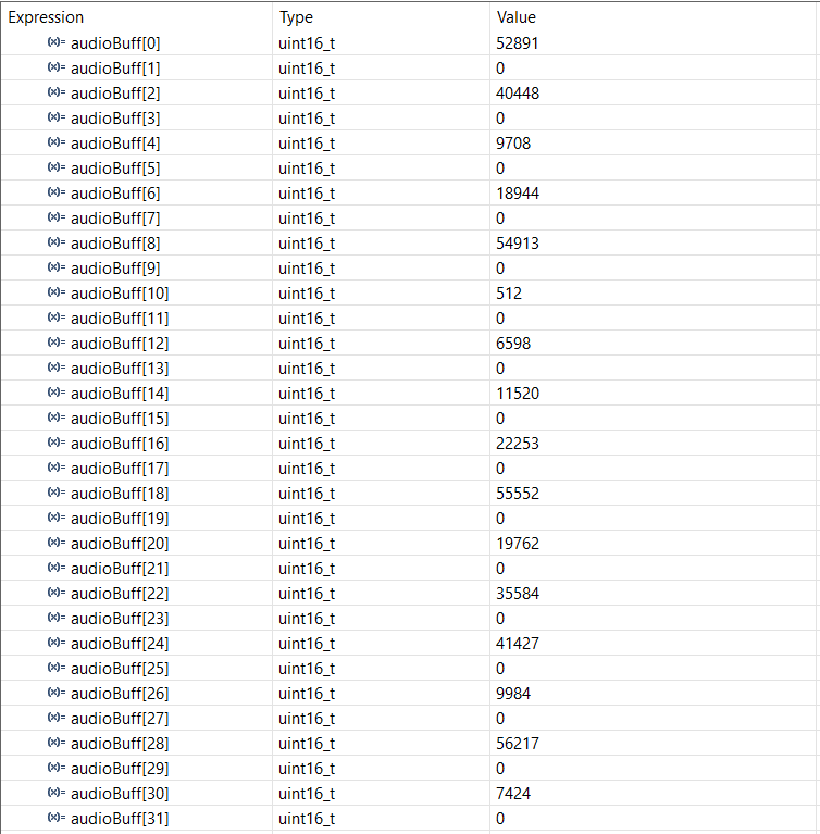

Hey LCE! I wanted to do some audio processing on the data before sending it back out to the DAC. I have been using a unit16_t array of size 32 have been using 48 and 96 for the buffer size argument of the HAL_I2S_Receive_DMA(I2S_HandleTypeDef *hi2s, uint16_t *pData, uint16_t Size).
My buffer seems to start getting filled up now but with what seems to be garbage values. I am also getting a weird effect where only half of the indexes in the buffer get filled up. Any ideas of what this could be?0693W00000GVxrKQAT.pngI know you have strongly suggested staying away from HAL since it has proven to be buggy and problematic in the past. I will certainly try to diverge from it and focus on the reference manual now.

You say your frame is 32 then your size for DMA is multiplied 2. And pointer and array is only symbolic uint_16
your array need be 32 and source played or setup ADC need 24 bits for you can see second part not zero.
