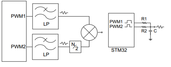

Before diving into the firmware, a few notes about the hardware construction. We’ll aim to have a 16bit resolution in total when using the PWM, this will be done by separated it in 8bit for the MSB (TIM3 channel 1) and 8bit for the LSB (TIM3 channel 2) – to achieve this, the PWM output pins must pass thru a combined low pass filters as shown in the image below – note that there is a relationship between the resistor values, where R2 is obtained by dividing R1 by 256:

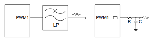

Alternatively, for a simple experiment, you can use just the MSB portion (TIM3 channel 1) and have a simpler low pass filter, like this:
The actual values used for this demo were: R1 = 8.2KOhm, R2 = 33Ohm C = 10nF, but the demo was also tested using only the PWM1 (no R2 connection), which provided a good output audio overall as well.

Since the goal is to have 16bits resolution divided by 2 PWMs, each portion segmented by 8bit resolution, we must configure the timer resolution to be equivalent to an 8bit variable, this means that the counter value should range from 0 up to 255 – this will be used later the STM32CubeIDE/configuration file.
The STM32G0 can go up to 64MHz and this application will use the PWM frequency at 125KHz, so we can have each audio sample outputted 8 times to ensure a stable quality audio level, thus rendering the actual audio output frequency as a 15.625KHz – a common sampled audio frequency.
The reason behind these numbers is to ensure the 16bit resolution in an exact amount. Here are the known parameters and how they reflect on the numbers we need:
