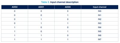

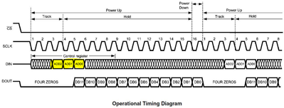

  I use ADC120 my new project, but device get only convert first channel. I change channel but its gives only first ch.

Channels are selected with the ADDx bits. Note the delay of one cycle before that channel is output.
