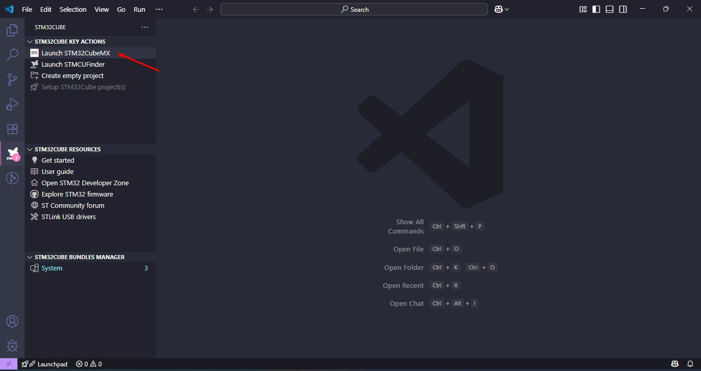

3. Create an STM32N6 CMake project

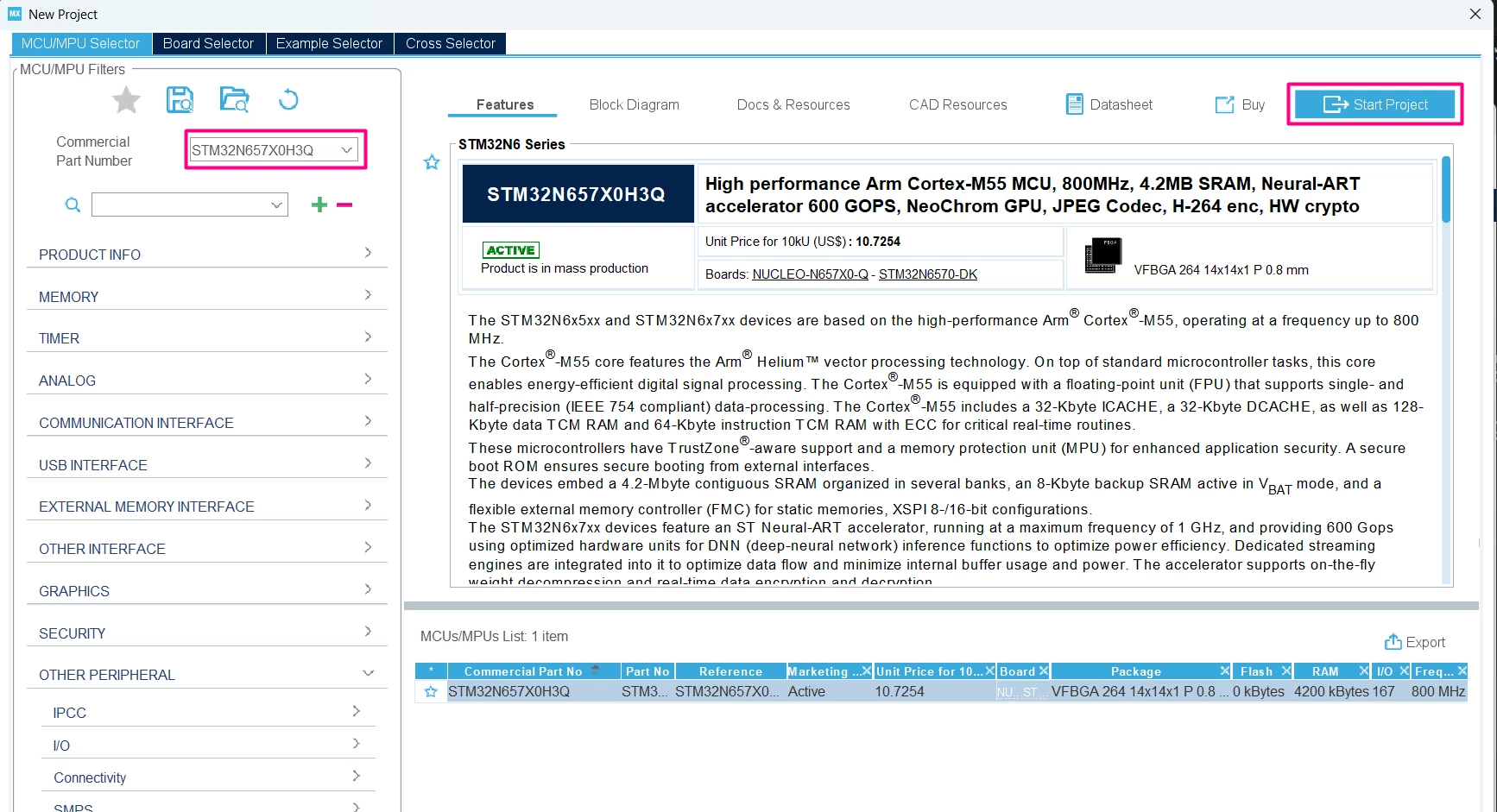

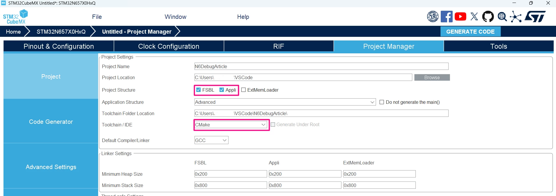

  • Create a new STM32CubeMX project, open VS Code, and click on [Launch STM32CubeMX]:
  • Select the [STM32N657X0H3Q]:

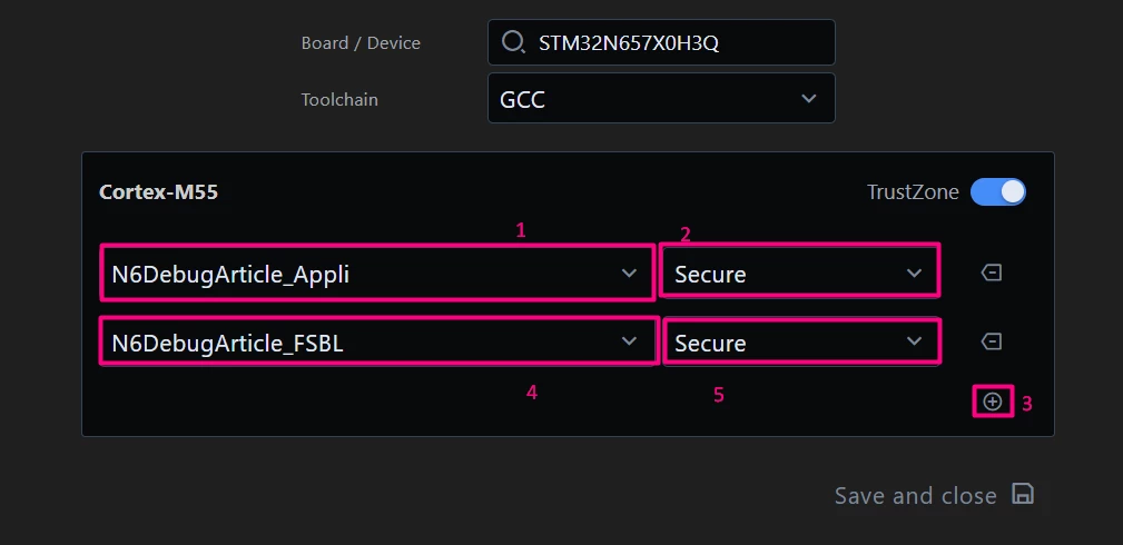

  • Select [Secure domain only]:
Configure the project to execute code from the external serial NOR flash. If you need assistance with this setup, we have published an article that explains the process in detail. You can find it here: How to execute code from the external serial NOR using the STM32N6.
  • Before the code generation, select the CMake toolchain:

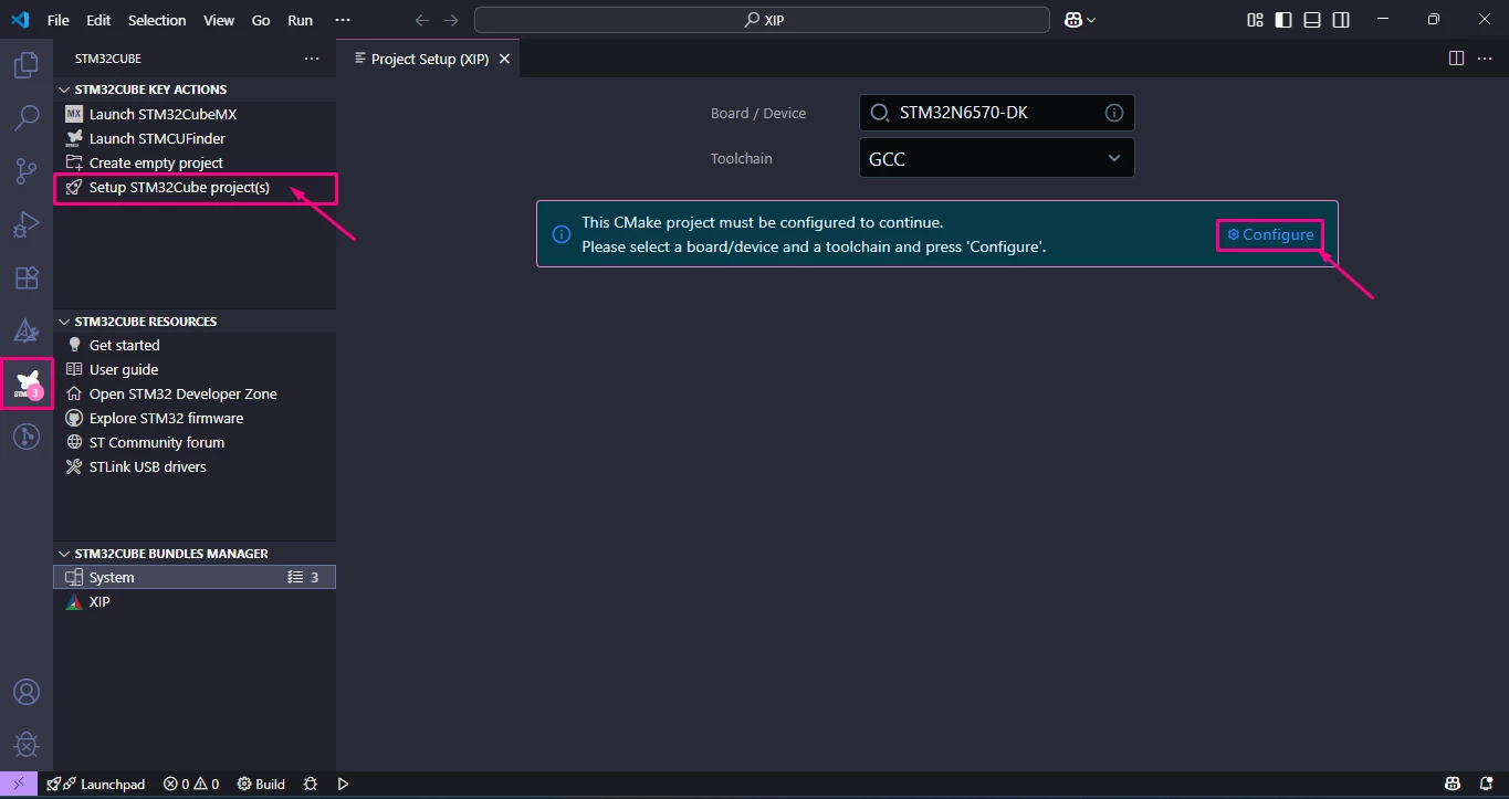

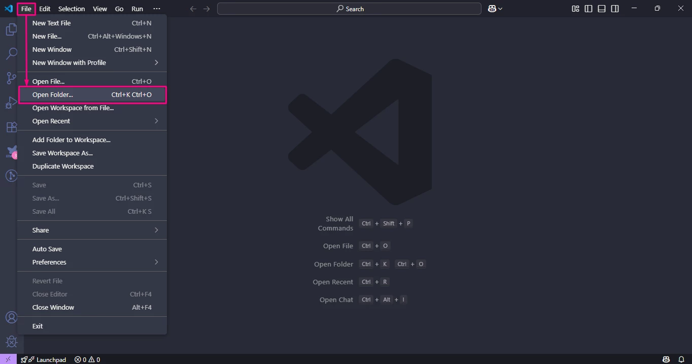

  • In VS Code, import the project folder:

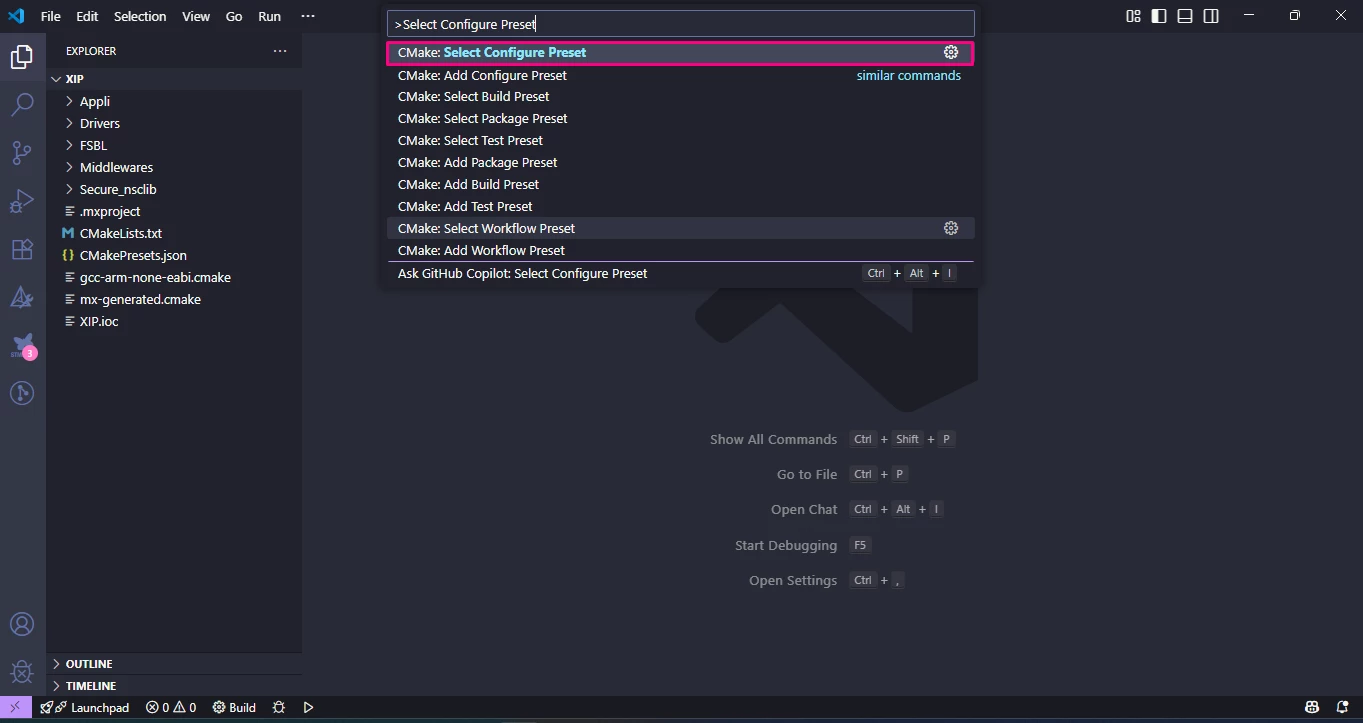

  • Configure the preset [Debug] by pressing Ctrl+Shift+P and type/select [Select Configure Preset] then click on [Debug]:
  • Configure CMake discovered Project as STM32Cube Project:
  • Add [PROJECT_NAME_Appli] and [PROJECT_NAME_FSBL] to your environment, save and close:

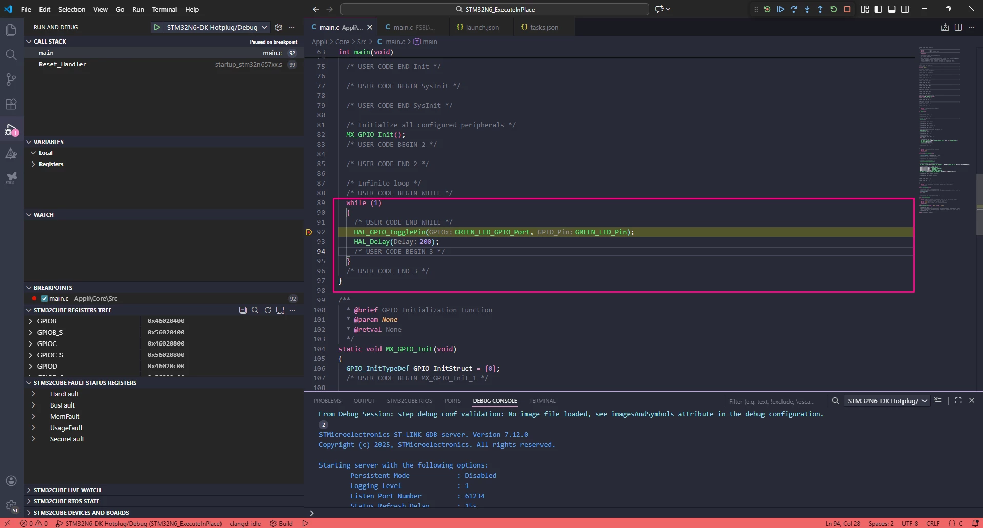

In the [Appli] project, locate the main.c file and add the toggle LED function call in its main loop:
/* Infinite loop */
/* USER CODE BEGIN WHILE */
while (1)
/* USER CODE END WHILE */
HAL_GPIO_TogglePin(GREEN_LED_GPIO_Port, GREEN_LED_Pin);
HAL_Delay(200);
/* USER CODE BEGIN 3 */
/* USER CODE END 3 */

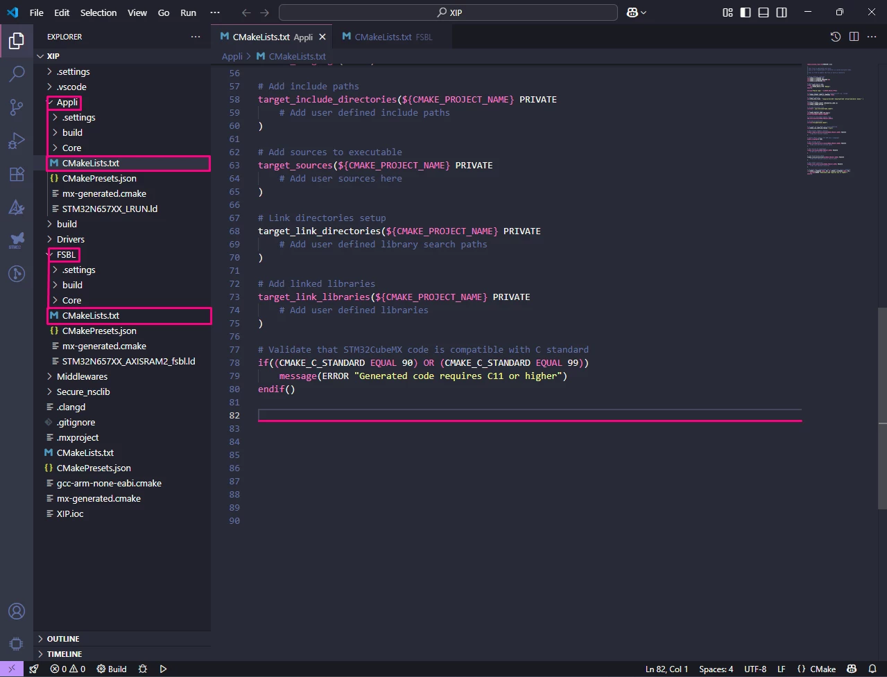

4.1 Edit the FSBL post build

4.2 Edit the Appli post build

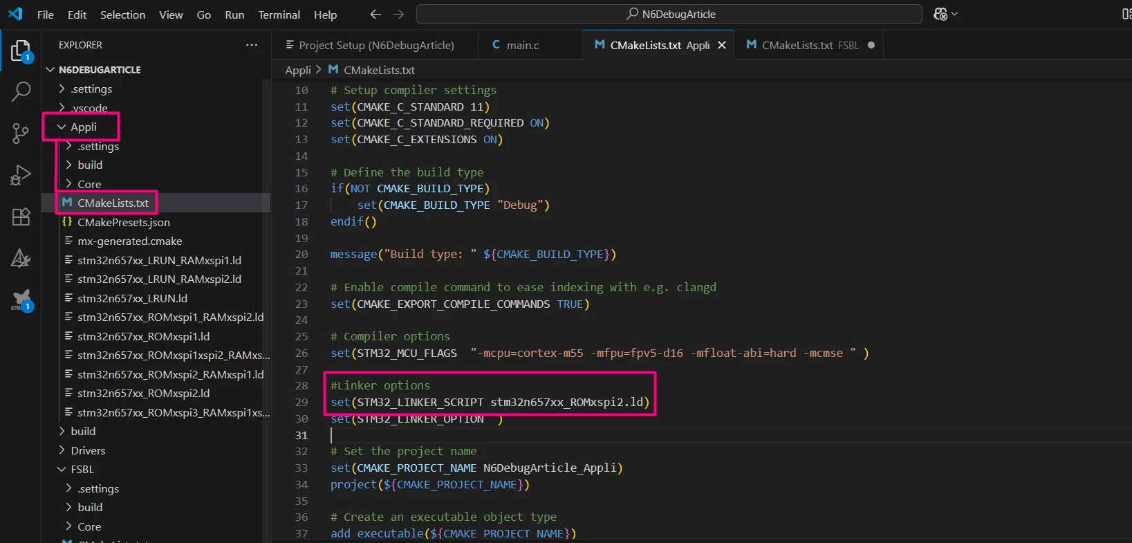

4.3 Linker script for execute in place (XIP)
The default linker script generated by the CMake for the [Appli] project is configured for the selected operation configured in the STM32CubeMX’s EXTMEM_MANAGER, where the selected was XIP. Double check that the linker script used in [Appli] CMakeLists.txt is indeed the correct one:
Note: STM32CubeMX version 6.15 has a minor bug on the linker script creation for CMake that causes a build error on VS Code. I recommend changing the content of said linker script with the equivalent one available in our GitHub here or use the attached on in this article (available at the end of the article.)

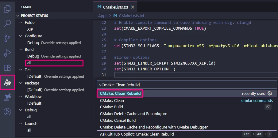

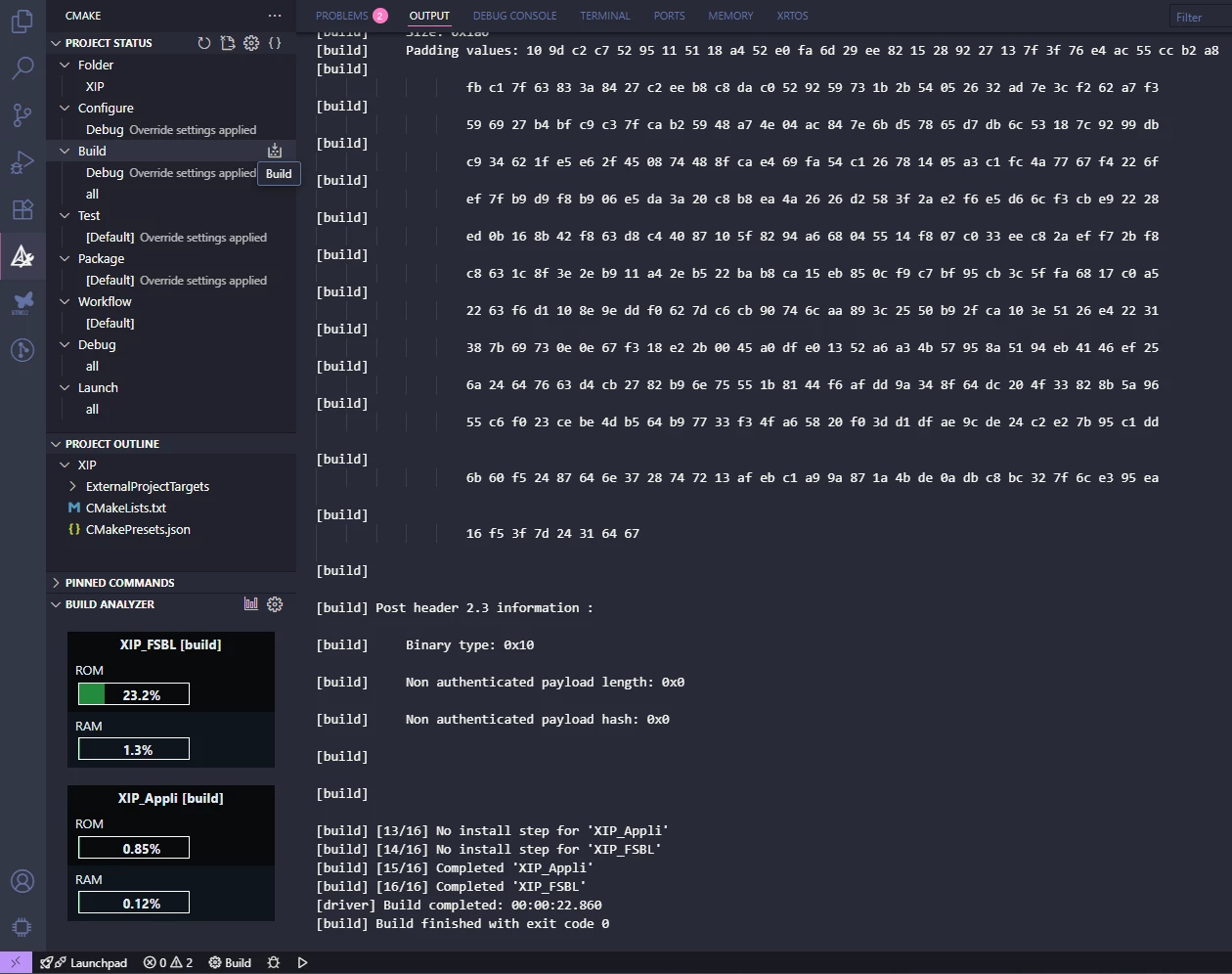

5. Build the project
Now that all steps are configured, it is time to build the application, locate the [CMake] icon on the left, then expand the [PROJECT STATUS] to locate the [Build] [All] to rebuild the projects. Alternatively, press Ctrl+Shift+P and then type/click [CMake: Clean Rebuild] for a clean and rebuild action.
You should see something similar to the following in the Build Analyzer (lower left corner) and Build Output window:

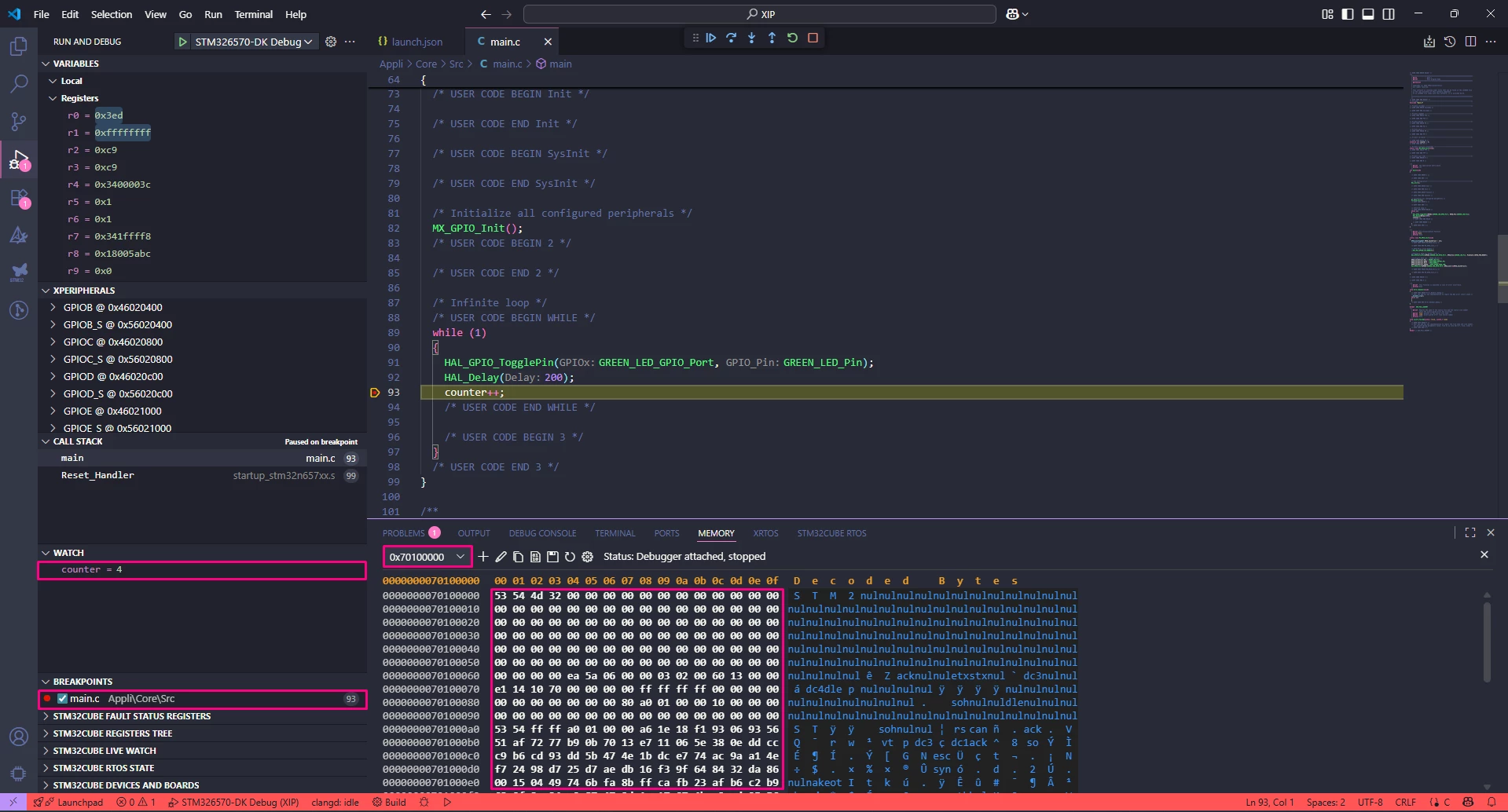

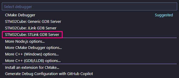

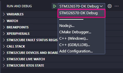

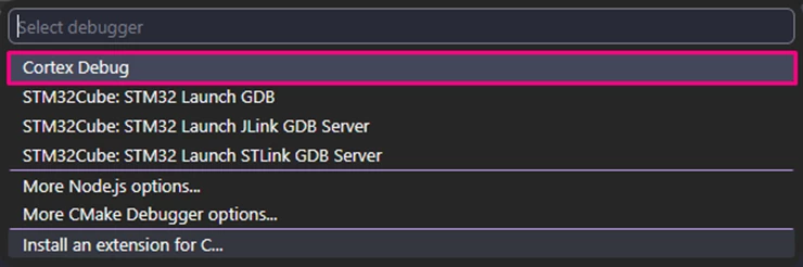

6. Create and modify the launch.json file
  • Open the Run and Debug view (Ctrl+Shift+D).
  • Click create a launch.json file.
The current recommended pipeline is to use the Cortex-Debug extension for STM32N6 XIP debug sessions.
Note: The previous stlinkgdbtarget-based launch configuration is no longer the recommended workflow for this STM32N6 XIP use case.
Edit the generated launch.json to support debugging with all features enabled.

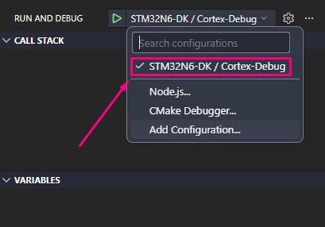

"version": "0.2.0",
"configurations": [
"cwd": "${workspaceFolder}",
"executable": "${workspaceFolder}/FSBL/build/STM32N6_XIP_FSBL.elf", // Replace this with your path and your_FSBL.elf
"name": "STM32N6-DK / Cortex-Debug",
"request": "launch",
"type": "cortex-debug",
"servertype": "stlink",
"runToEntryPoint": "BOOT_Application", // Set in BOOT_Application
"svdPath":"C:/ST/STM32CubeCLT_1.21.0/STMicroelectronics_CMSIS_SVD/STM32N657.svd", // Replace with your .svd path
//"preLaunchTask": "Flash STM32N6 (DEVBOOT)",
"serverArgs": [
"-m",
"1",
"-el",
"C:/Program Files/STMicroelectronics/STM32Cube/STM32CubeProgrammer/bin/ExternalLoader/MX66UW1G45G_STM32N6570-DK.stldr" // Replace with your external loader path
"overrideLaunchCommands": [
"-target-download",
"monitor halt"
"postLaunchCommands": [
"add-symbol-file C:/Users/%user%/STM32CubeVSCode/Demos/STM32N6_XIP/Appli/build/STM32N6_XIP_Appli.elf" // Replace this with your path and your_Appli.elf
6.1 Explanation of the launch.json file changes
Changed the debug configuration name:
The "name" field was updated from a generic label to "STM32N6-DK / Cortex-Debug" to clearly identify the target board and make the configuration easier to recognize in the VS Code interface.

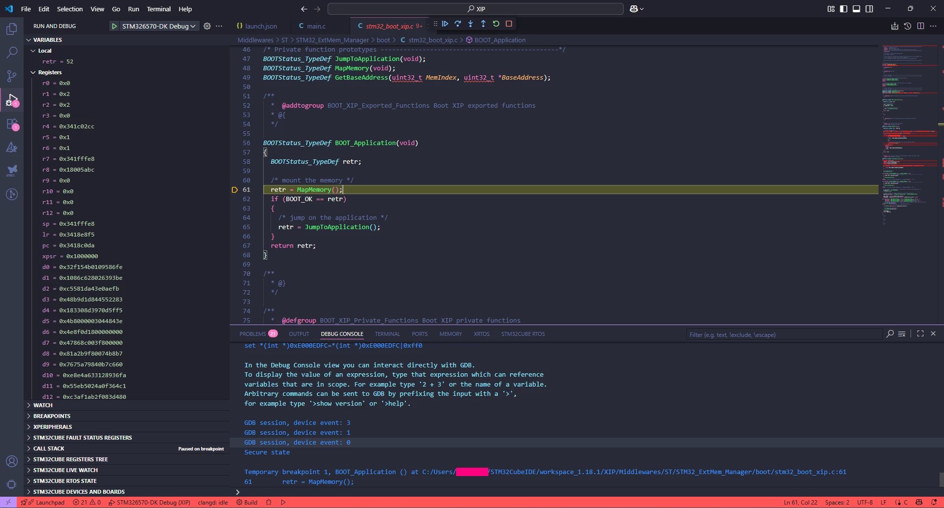

Main executable set to the FSBL ELF:
The FSBL is the first valid executable after reset. It is responsible for configuring the external memory interface and enabling memory-mapped mode for the XIP application. For this reason, the debug session must start from the FSBL.
runToEntryPoint set to BOOT_Application:
As explained earlier in this article, breakpoints cannot reliably be placed in application code stored in external memory before the FSBL configures the memory in memory-mapped mode. BOOT_Application is the first safe point after this configuration is completed, so it is used as the initial debugger stop point.

This loads the application ELF as an additional symbol file. In resume:
  • the FSBL ELF is the main executable used to start the debug session
  • the Appli ELF is loaded for symbol resolution only
This gives source-level visibility into the XIP application once execution reaches the application stage, without changing the trusted binaries already programmed into flash.

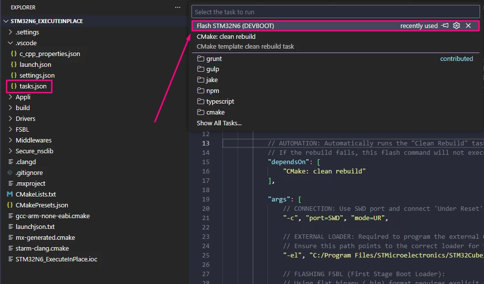

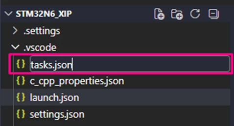

7. Create and modify tasks.json
Although the debug session uses the FSBL ELF as the main executable and the application ELF for symbols, the trusted signed binaries must still be programmed into the device before debugging.
This is important because the trusted binaries are the images actually required by the STM32N6570-DK secure boot flow and by other boot modes beyond the current debug session.
In this workflow:

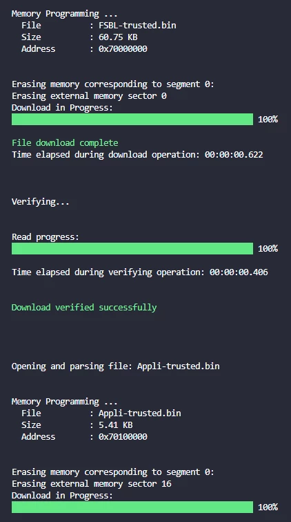

  • FSBL-trusted.bin and Appli-trusted.bin are flashed into external memory using STM32CubeProgrammer CLI
  • these are the persistent trusted images used by the MCU boot flow
  • the -target-download command in the debug launch configuration downloads the unsigned FSBL ELF only temporarily for the active debug session
In other words, the debugger download is session-local, while the trusted binaries flashed by the task are the persistent bootable images.
For this reason, the recommended approach is to flash the trusted binaries first using STM32CubeProgrammer CLI, then start the debug session.

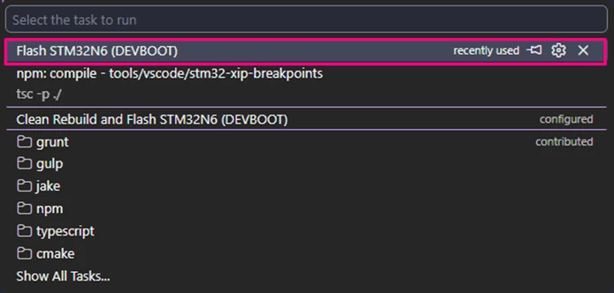

Flash using a VS Code task
Create the following .vscode/tasks.json file:
"version": "2.0.0",
"tasks": [
// This task invokes the STM32CubeProgrammer CLI to program the board.
// REQUIREMENT: Board must be in DEVBOOT mode (BOOT1=1) for this to succeed.
"label": "Flash STM32N6 (DEVBOOT)",
"type": "process",
"command": "STM32_Programmer_CLI",
"args": [
// CONNECTION: Use SWD port and connect 'Under Reset' (UR)
"-c", "port=SWD", "mode=UR",
// EXTERNAL LOADER: Required to program the external memory.
// Ensure this path points to the correct loader for the STM32N6 DK.
"-el", "C:/Program Files/STMicroelectronics/STM32Cube/STM32CubeProgrammer/bin/ExternalLoader/MX66UW1G45G_STM32N6570-DK.stldr",
// FLASHING FSBL (First Stage Boot Loader):
// Using flat binary (.bin) format requires explicit start address (0x70000000).
"-d", "${workspaceFolder}/FSBL/build/FSBL-trusted.bin", "0x70000000", "-v", // Verify after write
// FLASHING APPLI (Main Application):
// Using flat binary (.bin) format requires explicit start address (0x70100000).

7.1 Explanation of the task
Explicit SWD under-reset connection:
The task uses "-c", "port=SWD", "mode=UR". This selects the SWD debug port and connects under reset, which is more robust for this type of low-level secure/XIP flow.
External loader:
The task specifies “-el”, “external loader path”. This loader is required to program the external memory device used by the STM32N6570-DK board.
Flashing FSBL and Application signed binaries:
The task flashes:
  • FSBL-trusted.bin at address 0x70000000
  • Appli-trusted.bin at address 0x70100000
The addresses are provided explicitly because the input files are flat .bin images.
This ensures that the binaries are written to the correct locations in external memory.
Running the task
After saving tasks.json, run the task with:
Ctrl+Shift+P → Tasks: Run Task → Flash STM32N6 (DEVBOOT)
This flashes the signed FSBL and application binaries.
Optional use as a pre-launch task
If desired, the flash task can also be called automatically before starting the debugger by uncommenting the preLaunchTask line in launch.json:
If you prefer to manually control flashing and debugging separately, you can leave preLaunchTask commented out and run the flash task only when needed.
8. Start debugging
  • Connect your STM32 board to your PC using the ST-Link debugger.
  • In VS Code, select the debug configuration you created.
  • Press F5 or click the green Start Debugging button.
The debugger starts from the FSBL, loads the application symbols, and automatically runs to:
The code starts in the FSBL application running from an address within AXISRAM2. After the code stops here, press [F5] Continue. The green LED should start blinking on the board.
By pausing the code execution, you can confirm that it is running from the external flash by inspecting the function addresses in the call stack. At this stage, all standard debugging features become available, allowing you to:
  • Set breakpoints.
  • Step through your program.
  • Inspect variables, registers, and memory.
  • View call stacks.
Note: Remember that keeping existing breakpoints between debug sessions can cause failure messages when entering debug mode. If a failure message appears when attempting to enter debug mode, try power cycling the board.

Example .vscode/tasks.json:
 "version": "2.0.0",
 "tasks": [
 "type": "process",
 // AUTOMATION: Automatically runs the "Clean Rebuild" task first.
 // If the rebuild fails, this flash command will not execute.
 "dependsOn": [
 "CMake: clean rebuild"
 "args": [
 // EXTERNAL LOADER: Required to program the external Octal-SPI/HyperFlash.
 "-d", "${workspaceFolder}/Appli/build/Appli-trusted.bin", "0x70100000", "-v" // Verify after write
 "problemMatcher": []
After saving tasks.json, run it via:
  • Ctrl+Shift+P → Tasks: Run Task → Flash STM32N6 (DEVBOOT)
Step C: Debug using Hotplug (Attach-like)
Once the images are flashed and verified:
  • Switch the board to Flash Boot mode (BOOT1=0, BOOT0=0).
  • Power cycle the board so that the BootROM authenticates the FSBL and jumps into it.
  • FSBL runs, executes your debug‑unlock sequence, then continues.
Now you want a launch configuration that only attaches and does not reset the target or try to re‑flash anything.
Example .vscode/launch.json:
 "version": "0.2.0",
 "configurations": [
 // CONFIGURATION: HOTPLUG / ATTACH MODE
 // Use this when the board is in FLASHBOOT (BOOT1=0).
 // It connects to the running target without resetting it, allowing you to debug in
 //FLASHBOOT mode
 "name": "STM32N6-DK Hotplug/Debug",
 "type": "stlinkgdbtarget",
 "request": "launch", // logic acts as 'attach' due to serverReset: None
 "origin": "snippet",
 "deviceName": "STM32N657",
 "deviceCore": "Cortex-M55",
 // CRITICAL: Tells the debugger NOT to reset the chip upon connection.
 // This preserves the state set by the Boot ROM and your FSBL unlock code.
 "serverReset": "None",
 "svdPath": "C:/ST/STM32CubeCLT_1.20.0/STMicroelectronics_CMSIS_SVD/STM32N657.svd",
 // SYMBOLS ONLY: notice 'imageFileName' is missing.
 // This ensures VS Code knows the variable names/line numbers
 // but DOES NOT attempt to flash the code (which would fail in Secure Boot).
 "imagesAndSymbols": [
 "symbolFileName": "${workspaceFolder}/Appli/build/STM32N6_ExecuteInPlace_Appli.elf"
 "symbolFileName": "${workspaceFolder}/FSBL/build/STM32N6_ExecuteInPlace_FSBL.elf"
 // LOADER WORKAROUND: The extension requires this block to be present.
 // We set 'initialize: false' to prevent the debugger from trying to
 // configure the external flash (which runs safely in the background).
 "serverExtLoader": [
 "loader": "C:/Program Files/STMicroelectronics/STM32Cube/STM32CubeProgrammer/bin/ExternalLoader/MX66UW1G45G_STM32N6570-DK.stldr",
 "initialize": false
With this setup:
  • VS Code will not reprogram anything.
  • It will attempt to attach to the running core, leaving the FSBL‑based debug unlock logic in place.
  • Once attached, you can set breakpoints in FSBL and Appli (both symbol files are loaded).
The Workflow Steps
  1. Flash in DEV Mode:
    • Set Switch to DEVBOOT mode (BOOT1=1).
    • Run Task: "Flash STM32N6 (DEVBOOT)".
    • Result: FSBL-trusted.bin and Appli-trusted.bin are correctly written to External Flash.
  2. Boot in FLASHBOOT Mode:
    • Set Switch to FLASHBOOT mode (BOOT1=0, BOOT0=0).
    • Power cycle the board.
    • Result: Boot ROM validates FSBL → FSBL runs → FSBL re-enables debug.
  3. Debug via Hotplug:
    • Press F5 on "STM32N6-DK Hotplug/Debug".
    • Result: Debugging with FLASHBOOT mode (BOOT1=0, BOOT0=0) is now possible.
