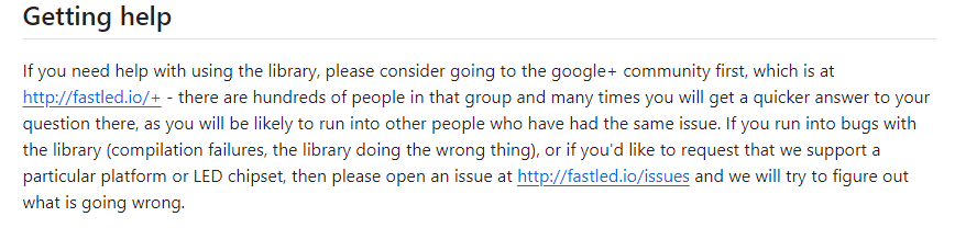

    I have found a librarie but one date is lost:
    https://github.com/thielj/FastLED-STM8/tree/master
    FastLED/platforms/stm8/hal/iostm8.h
    Did you follow the instructions for getting help with that library?
    Peter BENSCH
    May 7, 2024
    Welcome @Erik1, to the community!
    Since it is a library from Github (forked the project from FastLED) that has nothing to do with STMicroelectronics, you would have to ask the developer there, but he doesn't seem to want to be approached. I suspect that one of the files STM8S003F3.h or STM8S003K3.h needs to be copied to stm8/hal and renamed to iostm8.h.
    Hope that helps?
