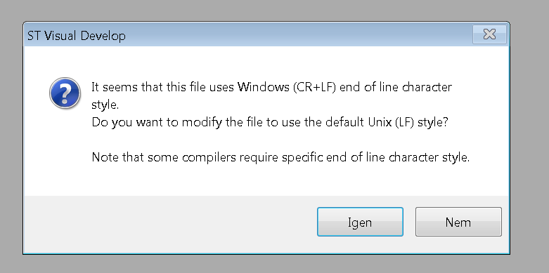

- Add a do not show this dialog again options for this dialog:
I am using git which strips out the \r-s from the files, and it is pretty annoying to click on this dialog every time when a file is opened. Furthermore as the notification says only some compilers are require this (Cosmic does not).

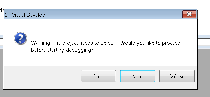

- Add option to start the debugger automatically. It is very annoying to press F5 every time when I start debugging.

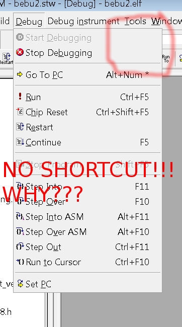

- It would be great if the start and stop debugging would have a shortcut key.

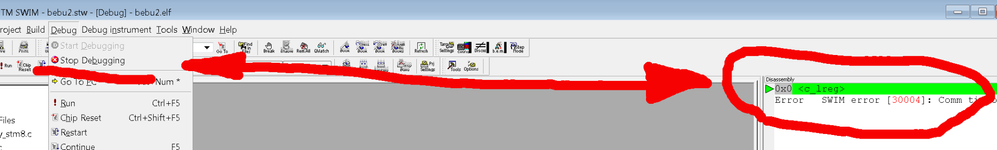

- It would be great if the debugger would be stopped automatically if the debugger sense an error:

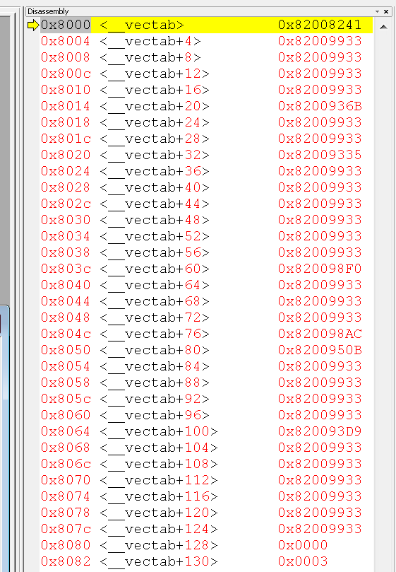

- Add ability to add watch variables while the debugged program is running. It would not be an issue if those variables would not be refreshed until the debugger is halted next time.
- Add ability to add breakpoints on the fly. If it is not possible to halt the debugger on the newly added points until the CPU is halted that should not be an issue.

Because most STM8 customers are -historically- using windows based environment, the LF/RT was overseen.

Of course I am also using it in Windows based environment, but my version control system replaces the line ends with UNIX style ones.

I would also like to get rid from this dialog:
It is a time consuming irrational dialog...
Check out any ''normal'' vendor tool's IDE: Texas CCS, MPLAB X. Neither of them has such an unintuitive feature...
