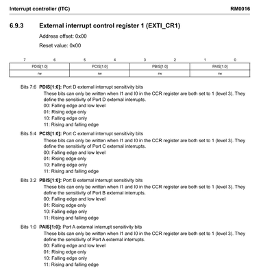

See RM0016 page 109, section 11.7.2 - Interrupt capability.
Code example for pin PA7:
EXTI_CR1 |= 0x01;	// Rising edge only
PA_DDR &= 0x7F;		// PA7 is input
PA_CR2 |= 0x80;		// enable interrupt on PA7
_asm("rim");		// Enable global interrupts

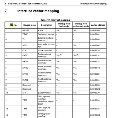

In Interrupt vector table, put the address of your interrupt handler in EXTI0 entry.
You can't have two interrupt pins on same port because you can't know which pin generated the interrupt. Use two ports.

Code example for pin PC3:
EXTI_CR1 |= 0x10;	// Rising edge only
PC_DDR &= 0xF7;		// PC3 is input
PC_CR2 |= 0x08;		// enable interrupt on PC3
 In Interrupt vector table, put the address of your interrupt handler in EXTI2 entry.
