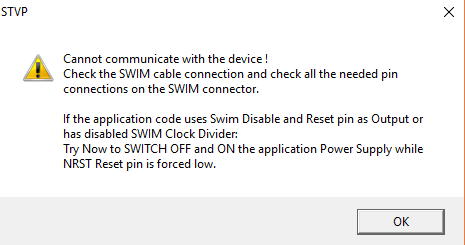

i use IAR EWSTM8 to debug and flash the STM8S103F3 controller which i have here on a small blue breakout board. Yesterday i flashed the Controller via the ST-Link V2 as always but instead of going into the debug menu, IAR gave me this on the console:
C-SPY Processor Descriptor V2.20.1.176 for STM8
C-SPY Debugger Driver, ST-LINK V2.20.1.176 for STM8
Failed to set configuration with MCU name STM8S103F3P: SWIM error [30006]: Comm init error: chip does not answer
The last code i successfully uploaded was this:

I was told to pull the NRST-Pin of the board to GND while switching power on / off and then try again, but that didn't help. I also tried to flash via STVP but i got this error message:
The last program i flashed works fine but putting a new program on the chip doesn't work
Anyone here who has a solution / ideas to this problem?

ahmad sina
Posted on January 22, 2017 at 13:49
maybe your NRST pin was Pulled down by hardware
i have same problem in the past
or you have high Impedance
junction between VCC and GND
loder
Posted on January 22, 2017 at 15:06
Hi and thanks alot for your answer,
What do you mean? Why should the board pull the NRST pin to GND from one moment to another? As i said i pulled the NRST pin to low (via a jumper wire) to mimic the SWIM-Initialization.
Could you explain in detail how you fixed the problem in the past, please?
Best regards
Posted on January 22, 2017 at 16:50
in my case the reset button was burn
so my MCU was reset Continuously
but in your case i dont know so much
i suggest you that put an amper meter before your supply and Measure the board amper
so you find that any part of you PCB is burn or not
Excuse me for my English
