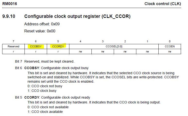

I have a discovery stm8s003k board and when I tested a program for cco capability it seems cco will never be stable and program always remain in line:
while(CLK_GetFlagStatus(CLK_FLAG_CCORDY) == FALSE);
code and more explain is in detail.
I tested it with below code and I even change pre-scalers for lower and higher frequency, I also check it with external crystal (and change the code) but it remains in
forever.
When I debug the code and step over in debugger environment after the program enables CCOEN bit the output will start and frequency is just true. but both flag CCOBSY remains set (CCOR=0x69 in debugger) and it always remain in while loop.
when i try cco out put in stm 32 it is also seem unstable for example every thing is ok but every 8 clock one of clock has a little change in frequency or duty cycle ,what is problem with mco or cco section? thanks for reply.

Had the same problem with CCO. The cpu is running on HSE with a crystal and AWU fed with the LSI
never exits when you select the CPU clock (divided or not) for CCO. It works fine when LSI is selected.
My temporary (dirty) solution was to simply comment out the check, as I simply wanted to see if the HSE stops in Active Halt Mode (it does).
I'll check later why the CCO flag does not work as expected.

Well, I think I found the problem in stm8s_clk.h.
In RM0016 you can see that CCOBSY and CCORDY are in the upper nibble of CLK_CCOR
I commented out the offending lines in stm8s_clk.h and replaced them with what I think they should be.
typedef enum {
  CLK_FLAG_LSIRDY  = (uint16_t)0x0110, /*!< Low speed internal oscillator ready Flag */
  CLK_FLAG_HSIRDY  = (uint16_t)0x0102, /*!< High speed internal oscillator ready Flag */
  CLK_FLAG_HSERDY  = (uint16_t)0x0202, /*!< High speed external oscillator ready Flag */
  CLK_FLAG_SWIF    = (uint16_t)0x0308, /*!< Clock switch interrupt Flag */
  CLK_FLAG_SWBSY   = (uint16_t)0x0301, /*!< Switch busy Flag */
  CLK_FLAG_CSSD    = (uint16_t)0x0408, /*!< Clock security system detection Flag */
  CLK_FLAG_AUX     = (uint16_t)0x0402, /*!< Auxiliary oscillator connected to master clock */
  //CLK_FLAG_CCOBSY  = (uint16_t)0x0504, /*!< Configurable clock output busy */
  //CLK_FLAG_CCORDY  = (uint16_t)0x0502 /*!< Configurable clock output ready */
  CLK_FLAG_CCOBSY  = (uint16_t)0x0540, /*!< Configurable clock output busy */
  CLK_FLAG_CCORDY  = (uint16_t)0x0520 /*!< Configurable clock output ready */
}CLK_Flag_TypeDef;
And now all options for CCO on my STM8S103F3 work as I expect them to.
EDIT: STM8S103K3 (LQFP32)
