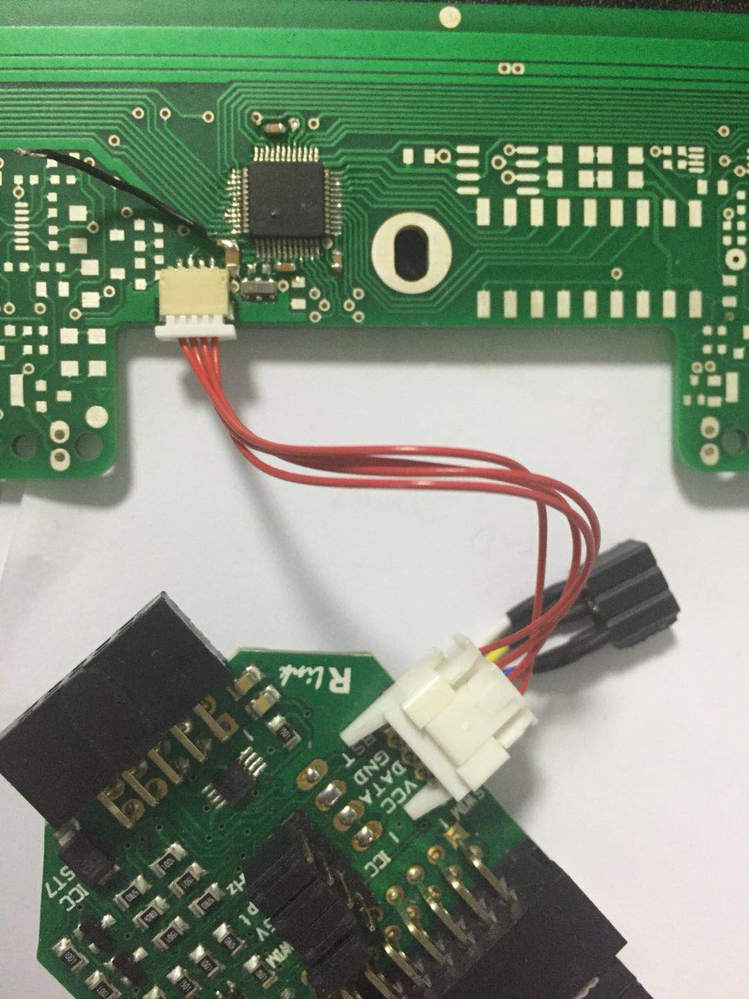

Dear all,
First I would like to thank you for any help that you might give me.
My purpose is to flash an empty code in the uC (STM8AF5288TAY) but its always says ''lost SWIM communication''.
After analyse of our self designed board, I remarked that the problem might come from the NRST pin of the uC.
There is only a condensator connected to this pin during my test :
But you can see that the signal NRST(shown below) is not pulled up as it should be :
If I remove the condensator, I have this on the NRST pin :
Please can someone tell me why I have this signal in the NRST pin while there is nothing going on? In my undersanding I should have 5V straight while nothing is happening; So where this signal comes from?
I am really looking forward for an answer or advice as I can not find the solution since weeks and cannot flash any program.
Thank you in advance,
Ye David

Tim Schuerewegen
Posted on May 01, 2018 at 23:48
Did you connect VDD to the VDDIO pin(s)?
Did you connect VSS to the VSSIO pin(s)?
Did you connect an external capacitor (470nF-3300nF) between the VCAP pin and VSS?
Posted on May 02, 2018 at 12:43
Hi Tim,
Thank for the reply.
Yes VDD and VDDIOs are connected, VSS and VSSIOs as well. There is also a external capacitors VCAP-VSS which is 1uF.
Below, you can see how I connect to flash the code; The PCB contains only the condos for the VDDs et VSSs, NRST pin and for VCAP.
(Don't care about the black wire, it is not connected)
Do you have any suggestion about this connection?
Best regards,
YE David

Posted on June 08, 2018 at 06:11
Hello Laurent,
We finally resolved the problem thanks to your comment.
All came from one misunderstanding. The Vcap was present on the electrical schematic design but not in our SMT machine programming files.
The flashing is working properly either with Raisonnance Rlink or with STVP RT-link.
Many thanks and best regards,
