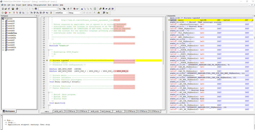

I am getting error if I am adding UART file in our program.
I have taken UART example provided in STM8S_StdPeriph_Examples and added those files in STM8S_StdPeriph_Template but without adding UART file everything is working fine but if I add UART file I am getting this error
#error clnk Debug\led_on_off.lkf:1 symbol _CLK_GetClockFreq not defined (Debug\stm8s_uart1.o )
compiler : cosmic
IDE: STVD
controller: STM8AF5288

So likely has a dependency on source file you're failing to provide in the project build.
Grep or find-in-file the entire library source to isolate where the body of that function resides.

Another problem is my normal program is not working. code is getting compiled but after entering in debug mode it's stopping on line number 36 as show in image. It is not going beyond line number 36

Likely need stm8??_clk.c file in project. Check for a file specific to your STM8 model.
en.stsw-stm8069\STM8S_StdPeriph_Lib\Libraries\STM8S_StdPeriph_Driver\src\stm8s_clk.c
