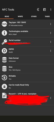

NFC-Tag:
- ISO 15693
- NfcV, Ndef technology
- 196 Bytes of data

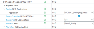

you have probably downloaded the X-CUBE-NFC9 package and have used STM32CubeMx to generate the code (standalone version or embedded in STM32CubeIDE).
Make sure to follow the step by step Getting Started (in <homeDir>\STM32Cube\Repository\Packs\STMicroelectronics\X-CUBE-NFC9\1.0.0\Documentation)
In particular, Sofware Packs / Select Components:
and in Middleware:
then the nfc_conf.h file should be properly generated.
Note: as of today the X-CUBE-NFC9 does not include the NDEF middleware. You can retrieve this middleware from the ST25 Embedded Library as well as the ndef demo application from the ndef_rw demo project.
Feel free to send me your ioc file and I will check it.

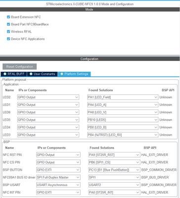

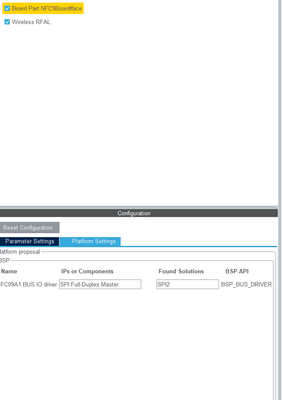

A Problem I do encounter is when generating code, I get this error in nfc_conf.h
  * @file           : nfc_conf.h
  * @brief          : This file contains definitions for the NFC9 components bus interfaces
  * @attention
  * Copyright (c) 2026 STMicroelectronics.
  * All rights reserved.
/* Define to prevent recursive inclusion -------------------------------------*/
#ifndef __NFC09A1_CONF_H__
#define __NFC09A1_CONF_H__
#ifdef __cplusplus
extern "C" {
#endif
FreeMarker template error (DEBUG mode; use RETHROW in production!):
The following has evaluated to null or missing:
==> SWIPdatas [in template "nfc_conf_h.ftl" at line 260, column 8]
Tip: If the failing expression is known to legally refer to something that's sometimes null or missing, either specify a default value like myOptionalVar!myDefault, or use [#if myOptionalVar??]when-present[#else]when-missing[/#if]. (These only cover the last step of the expression; to cover the whole expression, use parenthesis: (myOptionalVar.foo)!myDefault, (myOptionalVar.foo)??
FTL stack trace ("~" means nesting-related):
- Failed at: #list SWIPdatas as SWIP [in template "nfc_conf_h.ftl" at line 260, column 1]
Java stack trace (for programmers):
freemarker.core.InvalidReferenceException: [... Exception message was already printed; see it above ...]
at freemarker.core.InvalidReferenceException.getInstance(InvalidReferenceException.java:134)
at freemarker.core.Expression.assertNonNull(Expression.java:249)
at freemarker.core.IteratorBlock.acceptWithResult(IteratorBlock.java:104)
at freemarker.core.IteratorBlock.accept(IteratorBlock.java:94)
at freemarker.core.Environment.visit(Environment.java:370)
at freemarker.core.Environment.visitAndTransform(Environment.java:501)
at freemarker.core.CompressedBlock.accept(CompressedBlock.java:42)
at freemarker.core.Environment.visit(Environment.java:334)
at freemarker.core.Environment.visit(Environment.java:340)
at freemarker.core.Environment.process(Environment.java:313)
at freemarker.template.Template.process(Template.java:383)
at com.st.microxplorer.codegenerator.CodeEngine.freemarkerDo(CodeEngine.java:420)
at com.st.microxplorer.codegenerator.CodeEngine.genCode(CodeEngine.java:273)
at com.st.microxplorer.codegenerator.CodeGenerator.generateOutputCode(CodeGenerator.java:6459)
at com.st.microxplorer.codegenerator.CodeGenerator.generateSpecificCode(CodeGenerator.java:5281)
at com.st.microxplorer.codegenerator.CodeGenerator.generateSpecificCodeFile(CodeGenerator.java:1862)
at com.st.microxplorer.codegenerator.CodeGenerator.generateCodeFiles(CodeGenerator.java:2188)
at com.st.microxplorer.codegenerator.CodeGenerator.generateDefaultConfig(CodeGenerator.java:10991)
at com.st.microxplorer.codegenerator.CodeGenerator.generateCode(CodeGenerator.java:1593)
at com.st.microxplorer.plugins.projectmanager.engine.ProjectBuilder.generateCode(ProjectBuilder.java:3343)
at com.st.microxplorer.plugins.projectmanager.engine.ProjectBuilder.createCode(ProjectBuilder.java:2235)
at com.st.microxplorer.plugins.projectmanager.engine.ProjectBuilder.createProject(ProjectBuilder.java:819)
at com.st.microxplorer.plugins.projectmanager.engine.ProjectBuilder.createProject(ProjectBuilder.java:608)
at com.st.microxplorer.plugins.projectmanager.engine.MainProjectManager.startGenerateCode(MainProjectManager.java:1497)
at com.st.microxplorer.plugins.projectmanager.engine.MainProjectManager$3.onCommandEntered(MainProjectManager.java:283)
at com.st.components.util.CommandLineManager$3.run(CommandLineManager.java:175)
at java.desktop/java.awt.event.InvocationEvent.dispatch(InvocationEvent.java:308)
at java.desktop/java.awt.EventQueue.dispatchEventImpl(EventQueue.java:773)
at java.desktop/java.awt.EventQueue$4.run(EventQueue.java:720)
at java.desktop/java.awt.EventQueue$4.run(EventQueue.java:714)
at java.base/java.security.AccessController.doPrivileged(AccessController.java:400)
at java.base/java.security.ProtectionDomain$JavaSecurityAccessImpl.doIntersectionPrivilege(ProtectionDomain.java:87)
at java.desktop/java.awt.EventQueue.dispatchEvent(EventQueue.java:742)
at java.desktop/java.awt.EventDispatchThread.pumpOneEventForFilters(EventDispatchThread.java:203)
at java.desktop/java.awt.EventDispatchThread.pumpEventsForFilter(EventDispatchThread.java:124)
at java.desktop/java.awt.EventDispatchThread.pumpEventsForHierarchy(EventDispatchThread.java:113)
at java.desktop/java.awt.EventDispatchThread.pumpEvents(EventDispatchThread.java:109)
at java.desktop/java.awt.EventDispatchThread.pumpEvents(EventDispatchThread.java:101)
at java.desktop/java.awt.EventDispatchThread.run(EventDispatchThread.java:90)
The checkbox is also yellow, but it doesn't give a warning message something is wrong.
I have:  STM32CubeIDE Version: 1.19.0
Do you know a solution for this problem?

Hi William,
and in Middleware:

Just a few final things.
Should I need the Ndef, because it also has NfcV (screenshot)?
I fighting with my IT department to get the ST25 library on my PC.
I presume I need to implement BSP_NCF0X... and globalCommProtectCnt ?
So then it would be just as easy as following this application note If I have t correct.

Hi William,
The ST25 Embedded Library is a collection of source code provided in a self-extracting archive with a click-through license. The archive does not install any drivers, DLLs, or EXEs; it only copies source and project files into a specified folder.
NDEF (NFC Data Exchange Format) is a lightweight, standardized message format used to store and exchange data over NFC. NDEF relies on various NFC technologies, such as NFC-A, NFC-B, NFC-F, and NFC-V.
The use of NDEF depends on the application. For example, access control applications, such as ski passes, do not use NDEF, while Bluetooth® pairing applications use NDEF.
Regarding BSP_NCF0X... and globalCommProtectCnt linker issue, the previous post has been updated. In Software Packs > Select Components, an application must be selected. Currently, NFC09A1_PollingTagDetect is the only available application.
In the Middleware tab, select Device NFC Applications, complete the assignment of the various peripherals, and regenerate the code. There should not be any link errors.
Rgds
BT
Thanks a lot!
I got it reading the UID from my tag now just the data, but I'm sure I'll figure it out!
