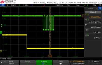

I’ve been working on implementing a SWIM master using an STM8 device to interface with a STM8S105K6 target. This is part of a tester software project that was previously using the ST7 debug protocol and is now being ported to the STM8.
I’ve followed the entry sequence described in UM0470, and I believe the waveforms match what's expected. Attached below is a screenshot from the oscilloscope:
  • Yellow trace = RESET pin
  • Green trace = SWIM pin
As you can see:
  1. A long low pulse initiates the SWIM entry sequence.
  2. Followed by 4 x 1kHz pulses and 4 x 2kHz pulses.
  3. Then I set the SWIM line high and switch it to input mode to await the slave response (Step 4 per UM0470).
However, no response is received from the target. The line stays high and never toggles.

ahsrabrifat
Senior II
If the target has an enabled watchdog timer and no main firmware, it could be resetting before responding. Either disable the watchdog or flash a basic dummy firmware to keep it alive.
