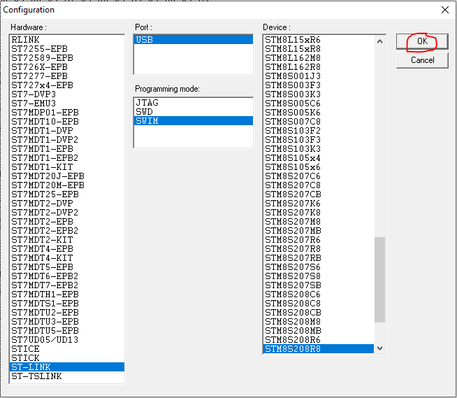

This issue is resolved with a workaround for ST Visual Programmer (STVP). I assume e better solution exists.
Option 1: Program the Nucleo-8S208RB with the STVP. Close STVP: the Nucleo's COM LED turns red and the application starts running.
Option 2: Program the Nucleo-8S208RB with the STVP. Open the Configuration window (see below): the COM LED turns ghreen. Click OK: the application start to run.
