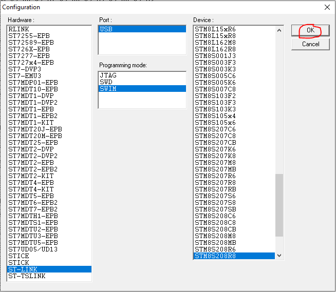

Update: the example code for ST Application Note AN5178 exhibits the same issue, therefore my source code above may not be the root cause. I am wondering if the ST Visual Programmer is not setup right? The LED2 flashes twice, first during programming, and the second time during code verification. But the following while(1) loop should flash the LED, and that is not happening. Any thoughts?

Hi Tesla, thanks for your quick response.
Connections:
* ST_Tools on Windows10 desktop -> ST-Link USB driver -> USB data cable -> ST-Link Debugger on Nucleo-8S208RB -> SWIM -> MCU.
Status update (success):
* After loading the .s19 firmware file with STVP the Nucleo's COM LED is green,
LED2 dos not blink.
* Re-open the STVP window 'Configure ST Visual Programmer' (screenshot attached).
* Click OK. The COM LED turns read and the User LED starts blinking!
Question:
* It seems that setting the STVP configuration (again) disconnects the Nucleo-64 board
and starts the program. Is that correct?
* What happens 'behind the scenes' when setting the STVP configuration.
