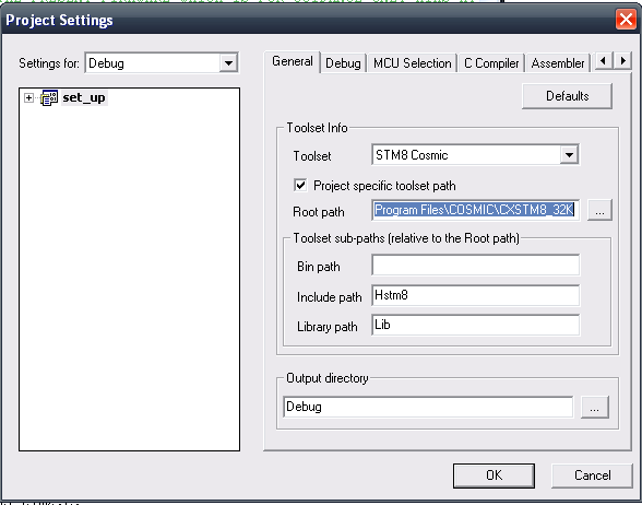

Posted on April 29, 2010 at 14:03
I've change the compiler path to fit with my environement.
you need to change the compiler path in project>settings
Just replace it by your Cosmic install path : ''E:\Program Files\COSMIC\CXSTM8_32K\''
Posted on April 29, 2010 at 14:16
I've changed the settings file to match what I have...
Still getting an error message...
Posted on April 29, 2010 at 14:35

----------- Project set_up - STM8 Cosmic - Configuration Debug -------------
Removing intermediate files ... Done!
Compiling libraries\stm8s_stdperiph_driver\src\stm8s_tim2.c...
cxstm8 -ilibraries\stm8s_stdperiph_driver\inc -iproject\inc +debug -pxp -no -l +mods0 -pp -i''E:\Program Files\COSMIC\CXSTM8_32K\Hstm8'' -clDebug\ -coDebug\ libraries\stm8s_stdperiph_driver\src\stm8s_tim2.c
#error cpstm8 E:\Program Files\COSMIC\CXSTM8_32K\Hstm8\mods0.h:1 FlexLM incompatible feature
libraries\stm8s_stdperiph_driver\src\stm8s_tim2.c:
The command: ''cxstm8 -ilibraries\stm8s_stdperiph_driver\inc -iproject\inc +debug -pxp -no -l +mods0 -pp -i''E:\Program Files\COSMIC\CXSTM8_32K\Hstm8'' -clDebug\ -coDebug\ libraries\stm8s_stdperiph_driver\src\stm8s_tim2.c'' has failed, the returned value is: 1
exit code=1.
set_up.elf - 2 error(s), 0 warning(s)
I've attached the current version of the file...
