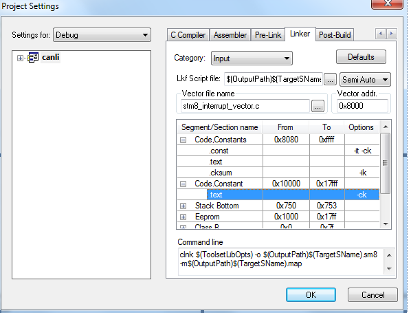

i have done another work
. Depends on these work. May you result anything?
We had one segmet(Code and constant) which locate 0x8080 to 0x17fff.
_block_checksum161() return CRC_ERROR.
Now we have 2 segment. First segment for constant and code where locate 0x8080 to 0xffff, seconds segment is for .text where locate 0x10000 to 0x17ffff.
block_checksum161() return OK
Unfortunately we can not use first segment for .text. .text which locate 0x8080 to 0xffff is not used.
?f .text of secons is overflow, it do not use .text of first segment. ?t gives overflow error.

‎2017-04-13 3:07 AM
from the Cosmic point of view, all you need to make the checksum work again after moving to a 'far' (>0xFFFF, that is 32k of code for the stm8) memory model is to use the far version of the checksum verification routine, and that is done automatically when you link libi instead of libi0.
For your case however, you seem to use some checksum verification routines that are not provided by us (_
block_checksum161()
), so the obvious answer would be to check with the provider of those routines (I guess that's ST) because I also see that some header files that you use force some variables @near, so I'm not sure if there is a @far version of the same file for when you change the memory model or if these variables are supposed to stay @near even when other parts of the code go @far..If you don't get out of it easily you can send your whole project to us and we'll take a look at it.
