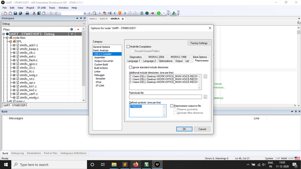

Hello, I found the issue! for an unknown reason, some definitions were not successfully getting added during the preprocessing stage. So, I personally modified the definitions in the "stm8s.h" header file by uncommenting the #define STM8S003.
At top of block with these macros is line:
/* Uncomment the line below according to the target STM8S or STM8A device used in your
  application. */
Everybody who want use "Standad libraries" should uncomment one line to select target STM8 family.
You don't need to uncomment or modify the libraries if you can add the definition in the preprocessor. But as I mentioned earlier, for an unknown reason, even adding the definition in the preprocessor wasn't good enough. 0693W000006FQ30QAG.png
You are right. Adding preprocessor definition works for me (using STVD and Cosmic).
