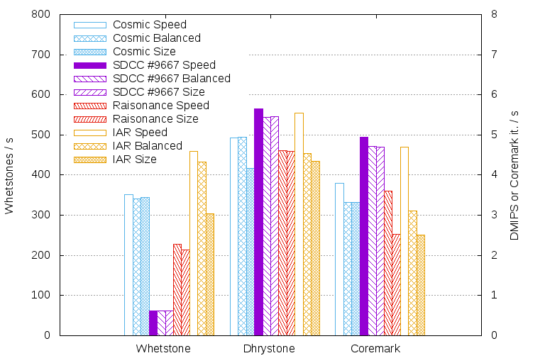

SDCC generates the fastest integer code for STM8
‎2016-07-25 3:39 AM
Code speed results didn't look that good for SDCC at the time of the SDCC 3.6.0 release about a month ago (http://colecovision.eu/stm8/compilers.shtml). But SDCC has made huge progress since, and now achieves higher Dhrystone and Coremark scores than the other compilers. Here are the results for the current development version (SDCC 3.6.2 #9667):
