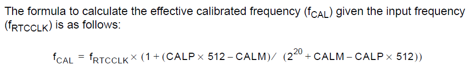

Question 1 :
Steps followed to calibrate the RTC temperature compensation
  1. RTC clock is 32768Hz, K = -0.04ppm/*c^2, To = 25*c, T = calculating from the internal junction temperature
  2. acc = 20 +  k *(T – To)^2;
  3. After calculating the acc, I have come up with this formula provided from ST's to Convert this PPM to clock
Here, I have attached the excel sheet to calculate both the negative and positive PPM value

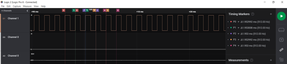

question 2: I have enabled calibration out for RTC 512Hz, and if I probe that to logic analyzer
I am seeing 0693W00000JPQKNQA5.png512.035
512.033
512.031
512.035
512.033
Average = 512.0334
(512/512.0334) - 1 *1000000 ==> -65.23ppm (but is this correct) since i referred from APP notes
