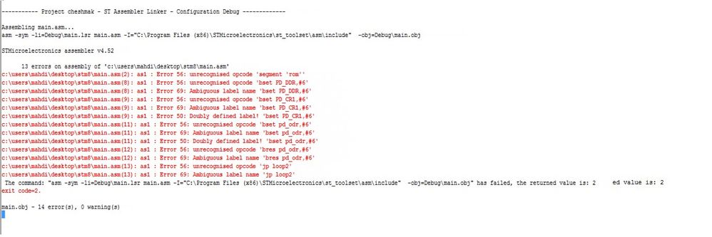

Hello. I want compile a simple program that is :
stm8/
segment 'rom'
PD_ODR EQU $500F
PD_DDR EQU $5011
PD_CR1 EQU $5012
bset PD_DDR,#6
bset PD_CR1,#6
loop2
bset pd_odr,#6
bres pd_odr,#6
jp loop2
end
when I compile this program Stvd get a lot of error that is :
can any one help me??
my windows is 7 and 64bit and I use from STVD and st assembler linker.
Thanks

Arlet Ottens
Posted on March 25, 2017 at 12:24
You need to start your lines with spaces or tabs, otherwise the assembler assumes you're defining a label.  Like so:
stm8/
    segment 'rom'
PD_ODR EQU $500F
PD_DDR EQU $5011
PD_CR1 EQU $5012
    bset PD_DDR,#6
   bset PD_CR1,#6
loop2
   bset PD_ODR,#6
   bres PD_ODR,#6
   jp loop2
   end
