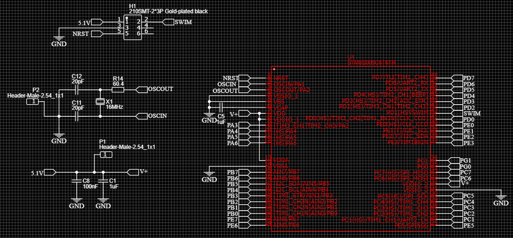

Is there any special considerations for the SWIM connection on the STM8S005C6 compared to the STM8S003?
OFern.1
I have recreated the same circuit i used to program the STM8S003 into a STM8S005 i built 2 boards but the software its not being able to connect to the MCU. I leave the schematic:
Is there anything Im missing could it be that the PCB traces in my board are too long? or is it more likely that i damaged them during solderin?0693W000003RVaQQAW.png
