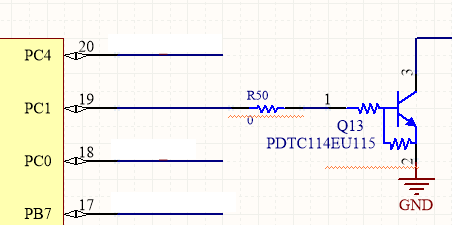

Hi all,
I am trying to use STM8L051 port c pin 0 as an output to drive a NPN. But I find that PC0 & PC1 cannot be set by using ST HAL library. All the registers seems ok (DDR, ODR, CR1 & CR2). And PC4,5,6 can be driven. Can anyone please give me a hand by providing some hints? AHere are the code:

Oops, sorry, I got it mixed up with the STM8S family library.
You are right, of course, but you should take into account that on the STM8L051 exactly two pins are so-called true open drain ports - PC0 and PC1. The RM0031 writes about this:
In the true open-drain I/Os, P-Buffer, weak pull-up and protection diode to VDD is not implemented.
This means: to drive an H-level at the output, you must connect an external pull-up, which provides the driving current for your npn BRT.

SSin.1
Thanks for your help.
Sorry for my poor explaination, what I mean is something tlike this:
