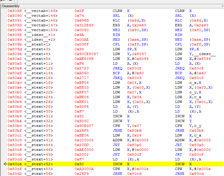

I tried to set a data break when the variable was set = 0 (Which never should happen) and it breaks at a assembly line saying:
fggnrc2
Posted on March 14, 2013 at 14:30
The breakpoint stopped your code in the initialization phase when all global variables are initialized, i.e. set to zero.
This means that your main() is still going to be executed, so this assembler dump is useless...
