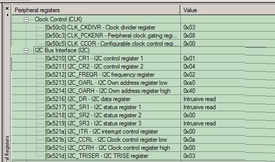

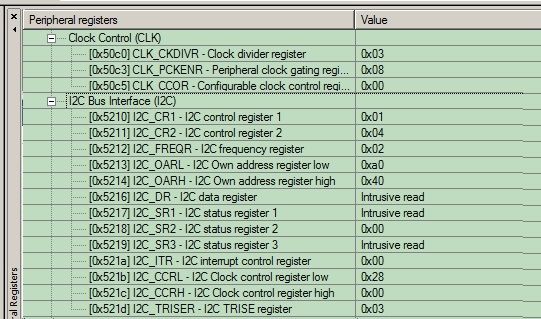

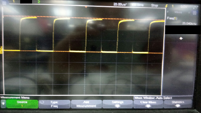

I have a #I2C setting problem on STM8L101, I am using the ST's ''STM8L10x_StdPeriph_Driver'' library and try to setup the I2C bus to run at standard mode 100KHz (with system clock of 2MHz) for reading a magnetic sensor. Unfortunately, it seems the I2C clock simply does not start properly.  However, if i slow down the I2C clock to 25KHz, the I2C bus becomes working normally and can get data from the magnetic sensor correctly.
Below is the program code that I used to configure the I2C interface of STM8L101:

    I2C_Init(100000, 0xA0, I2C_DutyCycle_2,I2C_Ack_Enable,I2C_AcknowledgedAddress_7bit); // Initialization of I2C peripheral
If I use the below code (using 100KHz I2C speed), the I2C clock does NOT output:
When I changed it to below code (using 25KHz I2C speed), the I2C clock can work correctly:
I2C_Init(25000, 0xA0, I2C_DutyCycle_2,I2C_Ack_Enable,I2C_AcknowledgedAddress_7bit);

1 REPLY 1
Simon V.
Posted on May 03, 2017 at 10:51
I would suggest to review the system clock configuration. Regarding the product datasheet, the I2C peripheral can work up to 8MHz. I would advise you to use the internal HSI @ 16MHz.
Datasheet link :
