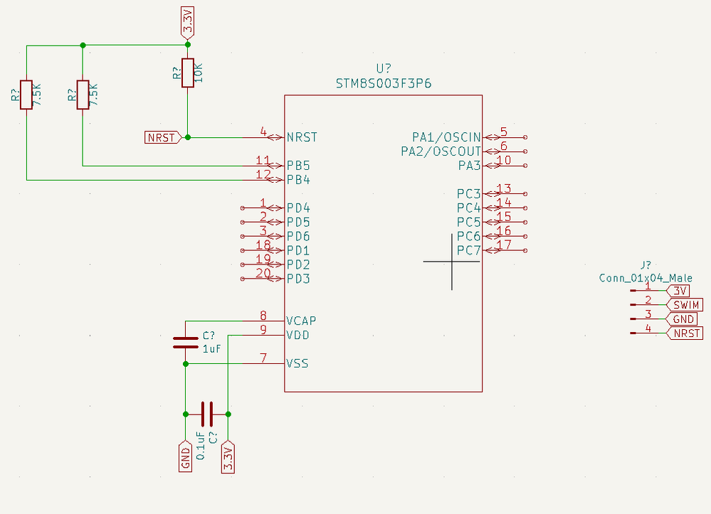

I am trying to get I2C working for STM8S003F3P6 with ESP8266. I tried I2C sample code available with standard periferal library https://www.st.com/en/embedded-software/stsw-stm8069.html . But for some reason I2c is not working. Now I just noticed the I2C pins PB4 and PB5 marked as open drain without any protection. So I wanted to check if I bricked these pins during my earlier testing sessions. So I written simple code to output on PB4,PB5 pins below, but I am not getting voltage on the PB4 and PB5 pin. I am getting correct output on PD4

 GPIO_Init(LED1_GPIO_PORT, (GPIO_Pin_TypeDef)LED1_GPIO_PINS, GPIO_MODE_OUT_OD_HIZ_SLOW);
 GPIO_Init(LED2_GPIO_PORT, (GPIO_Pin_TypeDef)LED2_GPIO_PINS, GPIO_MODE_OUT_PP_LOW_FAST);
I am using above circuit, I have pulled up PB4 and PB5 as these are open drain pins. I am measuring output from PB4 and PB5 pins and ground.
Can someone help if above setup is correct and if not how to check if PB4 and PB5 are not broken
