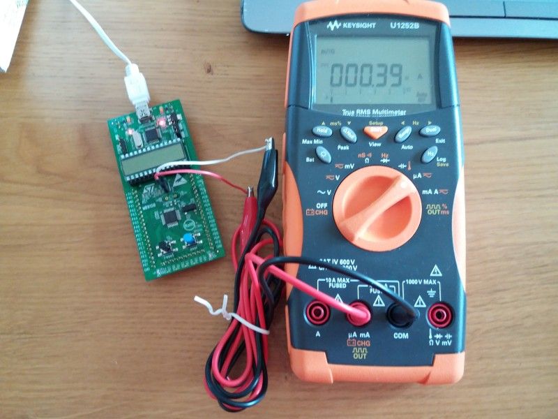

I tested this applicaion on STM8L Discovery kit. It contains STM8L152C6 device, but I am sure you can run it also on your STM8L052C6. With this code STM8L will enter Halt mode and it will wake up from EXTI interrupt (PC1). After waking up MCU will togle PE7. PC1 is connected to push button and PE7 is connected to LED. This application allowed me to reach 0.4uA in Halt mode, please see the picture below.

When running normal I'm drawing 1.3mA. When I call HALT, I can get around 200uA. No where near the advertised 0.4uA. What am I doing wrong? At this point I'm thinking errata, but I don't see anything noted anywhere. Please help. Anyone have example code?

Please find attached a simple example project. It was developed using STVD IDE (Cosmic compiler) and Standard Peripheral Library for STM8L.

Posted on May 09, 2018 at 07:36
Thanks. I was able to get it to work with that example code. I've noticed I can still only get it to work if I compile for 'Debug' because if I compile for 'Release' and load that onto the unit, it never goes into low power. But this is good enough for now. Thanks.
