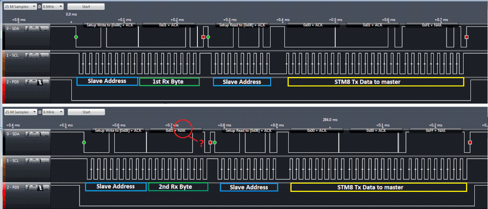

I'm using STM8L152C6 as a slave I2C device. I'm able to receive the first byte with acknowledge but successive rx data go along with NACKs. Here's my I2C configuration:

How should assert successive ACKs after receiving the first byte?
Could someone help me with this issue?
I also attach a screenshot of the I2C timing for further information.
Thanks in advance,
Gaston

I've finally found a workaround. After sending the 3 bytes to the host and setting ENABLE the Stop bit I add these two lines:
while (I2C_GetFlagStatus(I2C1, I2C_FLAG_STOPF));
I2C_GenerateSTOP(I2C1, DISABLE);
