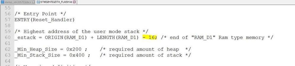

Hugues DE CARVALHO
Here is the workaround: use a stack address that is always more than "End RAM @ - 16 bytes". For instance I changed my stack pointer from SP=0x24008000 to SP=0x24007FFF0.
This can be done by changing _estack in the linker file:
This issue originates from a bug in the new bootloader. Here is what happens when the SP is set to the end of RAM:
* A POP on the stack is done by the bootloader after setting the stack value in the code stack.
* As we are using the limit address of the RAM, this POP will cause a hard fault before the jump
This issue should only affect STM32H74xxx/75xxx rev V boards and will be documented in AN2606.
Hugues

Hi Dub,
I've been told the following behavior was observed:
-IAR: Works correctly with SP=0x24080000
-Keil, Cube IDE, arm-gcc: Only works correctly with SP=0x24080000-0x10
Please let me know if you have observed a different behavior.
Regards,
Hugues
