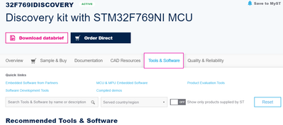

Hello @JakeW ,
The binary demonstration files for STM32F769I-DISCO are available under Tools & Software/Compiled demos section.
Sara.

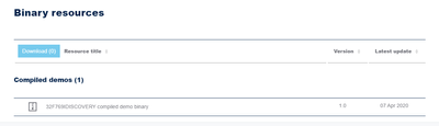

Sorry, but this is not the solution I was seeking.
I am searching for the exact firmware version 1.2.0 that was on my board before I started evaluating.
The package you pointed me to contains other binaries of V1.0.0 and V1.4.0.
Although those might possibly work I would like to restore the original bianry I received when I bought this board.
Regards, Jake.
