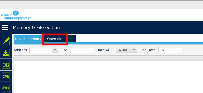

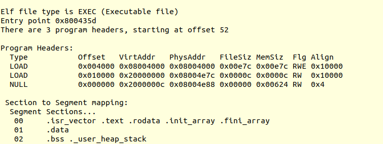

Hi, I have an ELF file modified to write to the main memory address 0x08004000 instead of 0x08000000. Please find the screenshot below and the ELF file in the attachment.
_legacyfs_online_stmicro_images_0693W00000bjWLTQA2.pngBut instead of writing to 0x08004000 it constantly writes to 0x08000000. Why is this happening?
26 REPLIES 26
Hi @bob S​, there is a tab named Open file in the IDE by which I had opened it.
Hi @yo3hcv​, thanks for pointing it out. I will try this fix.
This fix solved my issue. Now I can see the updated address in the program header

The linker scripts are very sensitive to ordering and interpretation.
Not sure I've seen it do the behaviour here, but I tend to lead with the FLASH address.
ST's implementation is a bit haphazard and could have been executed so much better. The crew at Arduino seem more clueful. And Keil/RealView have always been much better with the issues.
+1 for identifying the issue here correctly.
I've been here over a decade, it's like swimming up a waterfall..
The code generator is capable of replicating a lot of junky and broken code. Just get the confidence to see whats wrong and excise it from your own project.
@mattias norlander​ please flag this to the relevant team(s) need to define the FLASH / RO memory region first. Defaulting to 0x08000000 somewhere. Even in a single / linear pass sense it should be recognizing addresses explicitly provided over defaults, and before it's encountered any content.
