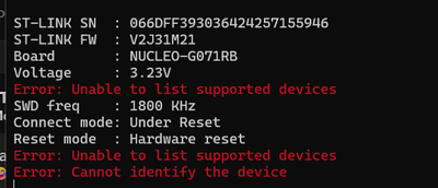

Hi everyone,
My program isn't establishing a connection to the controller.
FlashLoder and Data_Base are located right next to the .exe file in the /x64/Debug folder.
I've attached my program; maybe someone can point out where I'm going wrong.
It works fine with Example 2.
Thanks a lot
Best regards, Mathias89
1 REPLY 1
Aziz BRIGUI
Hi @Mathias89
In the way your project is structured, you'll need to put the Data_Base folder at the same level as "STLink_V01_XXX" folder. I also suggest you set the displayCallBacks as done in the main API file to have better logging in case of issues. If that was set you would have had a message like this one:
