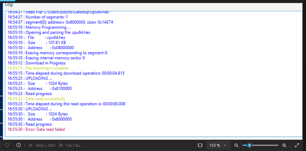

I am currently facing an issue with my STM32H743BITB microcontroller while using the STM32CubeProgrammer. I can successfully load the bootloader, and the software indicates that the boot has been loaded correctly. However, when I attempt to read the data, I encounter the following error message: "Error: Data read failed."
I would greatly appreciate your assistance in resolving this issue. Please let me know if there are any specific steps or settings I should verify.

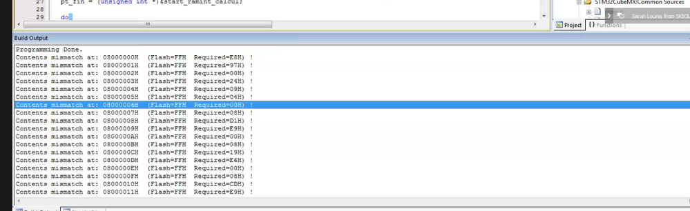

‎2024-09-04 6:50 AM
No, here's the full error message.
Load "C:\\Keil_v5\\workspace\\CPU64OS+USB2+ETH2\\Objects\\cpu64.axf"
Erase Done.
Programming Done.
Contents mismatch at: 08000000H (Flash=FFH Required=E8H) !
Contents mismatch at: 08000001H (Flash=FFH Required=97H) !
Contents mismatch at: 08000002H (Flash=FFH Required=00H) !
Contents mismatch at: 08000003H (Flash=FFH Required=24H) !

Too many errors to display !
Error: Flash Download failed - "Cortex-M7"
Flash Load finished at 10:06:38

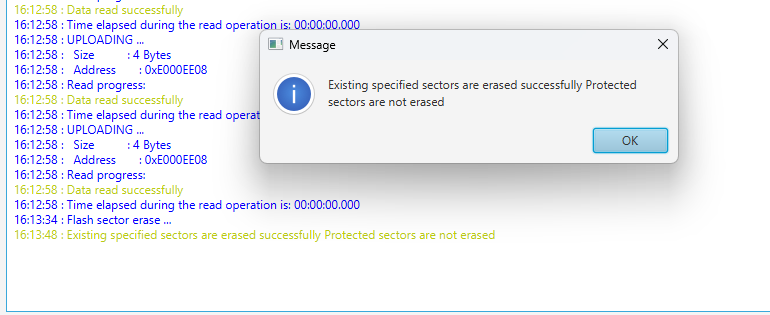

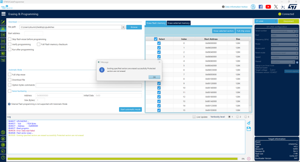

‎2024-09-04 6:58 AM
When I took the photo, my microcontroller was locked (RDP). Now it's okay, I can delete the sector in the flash, but I received this information (see photo). I think the sector is locked because I can successfully load the .hex file via STM32CubeProgrammer, but right after that, nothing happens, and I get a 'failed to read data' error.
