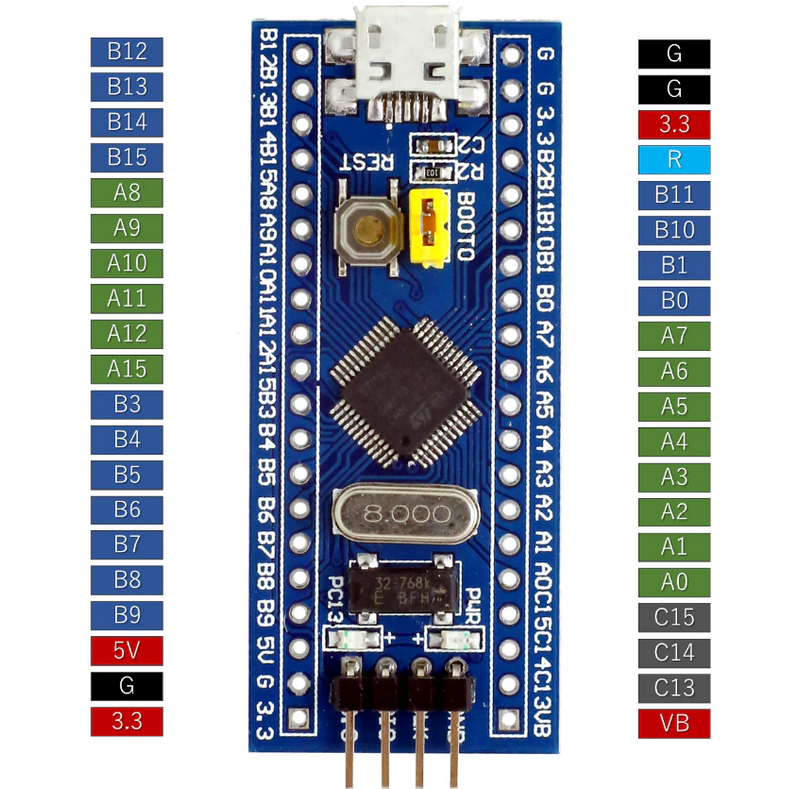

I'm attempting to read memory data of my STM32F030c8t6_board (I got boards on banggood.com, picture in details section). I can not connect to my device. See details section for explanations.
Best regards,
Sylvain
‎2021-05-04 7:30 AM
Used tools:
- stm32cubeprogrammer
- STLink-v2 (wired pins: 7:swdio, 9: swclk, 1: vcc, 8: gnd), the dev board usb is plugged to supply the chip.
- tried with all reset combinations, bus clock configs and boot0 config.
- tried with openocd as well (see console log below)
- tried with one of my own board (stm32f4x) to check if my tools are still working properly, I can read memory of the chip perfectly.
Questions:
- Do I miss something to make chip debug probe connection working ? I generally never had trouble to connect it to my boards. Anyway this is the first time I work on STM32f0 series.
- I heard possible fake MCU's sold on some websites (I used banggood, the price were quite low), do you thing it could be the case ?

Almost certainly the boards bought from banggood are counterfeit. May or may not be the issue here. I would double check solder connections and BOOT0 pin status.

Unfortunately, I tested 2 units and none of them worked (same behavior, even after trials to change boot0 pin status). Therefore, the soldering issue probability seems to be poor. I just have an other question: do you have another (more trustable) supplier of such parts ? I could try to order and test a few of these and finally notice if the parts behave similarly than those found on banggood.
‎2021-05-04 12:42 PM
Perhaps you can take a picture of the board/chip you actually have, the picture above seems like stock photography. Large, Clear and In Focus.
Does yours have the B2 or RESET pin? Connect Under Reset modes would need connection to the NRST pin of the ST-LINK/V2

What if they are just not flashed with any code so SWD peripheral is not set?
Where they blinking when you first plugged them to power out of the box?
by the way if its bluepill the normal chip you would expect is the stm32f103c8
