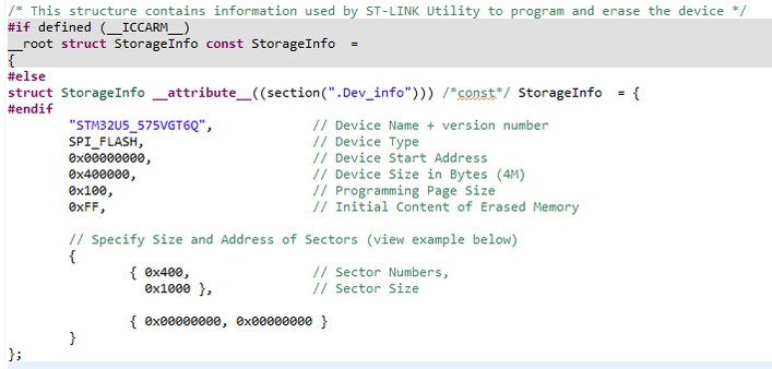

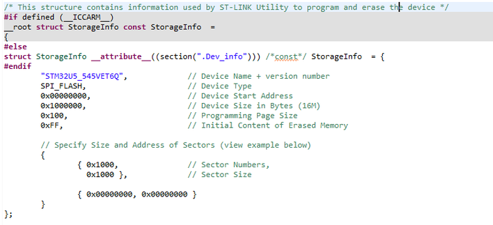

Hi, I've developed a custom ExternalLoader for STM32U575VGT6Q installed on my board, following the online guides provided by ST, obtaining a fully functional version. On the new version of the board I have an STM32U545VET6Q, so in ExternalLoader project I've carried out the necessary porting for the new micro pinout, and the memory was replaced with a larger one but with the same interface.
On the new version of the board with STM32U545VET6Q, my ExternalLoader has been successfully tested in debug, both in reading and writing, but it does not work when launched from CubeProgrammer (with both versions 2.13 and 2.14 of CubeProg, the only ones that support U545). I attach the CubeProgrammer logs in the two cases, obtained with Verbosity Level 3. I've tried to read small portions of the external flash, but the CubeProgrammer interface always shows the error message when reading (same behavior for writing).
From the logs (the figure below shows an extract of the reading procedure for both micros) I've noticed that in the case of the U545 it seems that the ExtLoader binary is not loaded into RAM, unlike what happens on the U575 (lines 97-99 of the U575 log, absent in U545). Following this (and probably related to the previous problem..) the Main Stack Pointer of U575 seems to point to a coherent memory location, while on U545 it points to zero.

The other is smaller, but both look to have incorrect StorageInfo structures and don't look to be describing QSPI/OSPI, and each describes different memory spaces starting at zero (TCM), one 64Mb (8MB) the other 256Mb (32MB). I suspect this zero addressing conflicts with other expectations within the memory space.
Perhaps set the basis as 0x70000000 or 0x80000000 ?
‎2023-10-26 4:13 AM
Correct, my external memories are both SPI flash and the used address for them is zero, it works on U575. I've tried to change it to 0x70000000 or 0x80000000 but the error result on U545 is the same. The memory used with U575 has 4MB size, the one used with U545 has 16MB size. These are the two StorageInfo screenshot from my code:
Anyway, I've also tried on U545 with empty read/write functions that return LOADER_OK without doing anything else and I have the same error, in this scenario the storage info should not have any impact. I haven't understood why the loader isn't written into ram.
