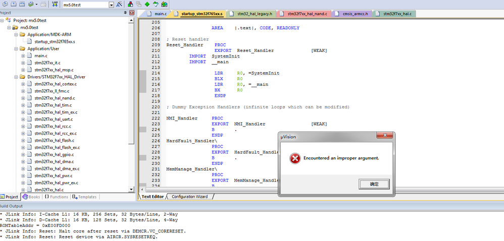

Why does Keil run crash when debugging with KEIL project generated by STM32CubeMX 5.0?
JLee.0
2 REPLIES 2
Jeroen3
Senior
Make sure you only use ASCII in paths and files.
http://www.keil.com/support/docs/4036.htm
Otherwise report the bug to keil.
Thank you for your answer.
but The source files for my entire project are all generated by STM32CubeMX 5.0, I have not added any source files.
