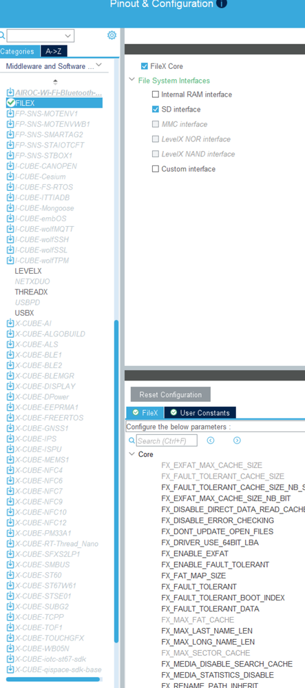

[STM32H573IT] I can't FATFS in CubeMX.
kadekade

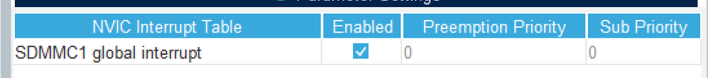

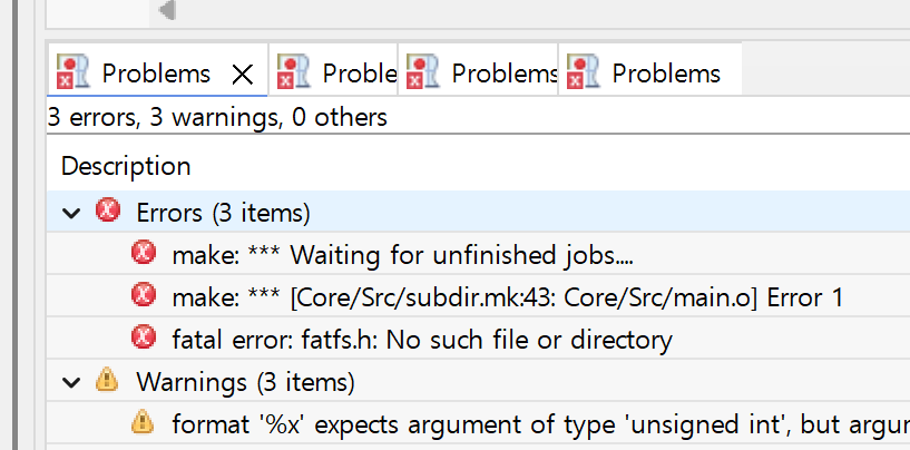

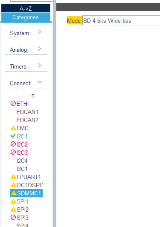

Hi Everyone,
I need your help.
I use STM32H573VIT but I can't FATFS in CUBEMX.
I checked FILEX, SD interface. But CUBEIDE say fatfs.h : No such file or directory.
Please help me out..
Thanks,
kadekade

AScha.3
>but I can't FATFS
Right, here no fatfs , you have to use filex , as you selected in Cube.
mount drive ->
/* Open the SD disk driver */
  sd_status =  fx_media_open(&sdio_disk, FX_SD_VOLUME_NAME, fx_stm32_sd_driver, (VOID *)FX_NULL, (VOID *) fx_sd_media_memory, sizeof(fx_sd_media_memory));

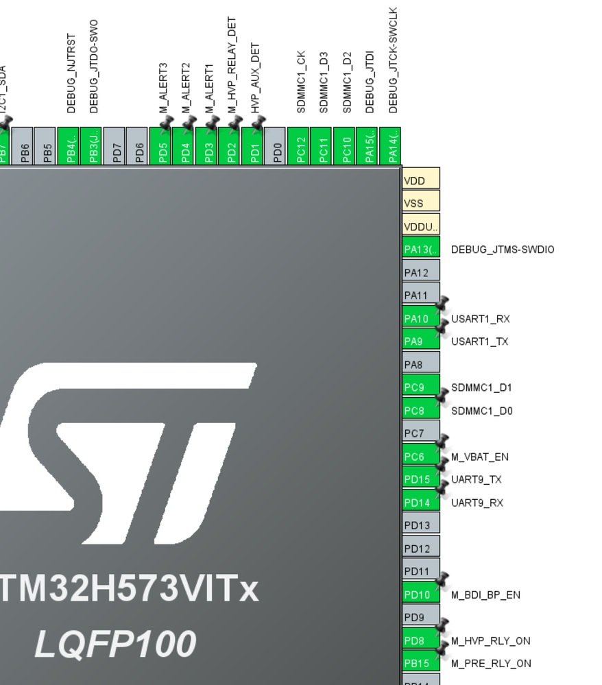

Dear Mahmoud,
I appreciate your help. I'm sorry to reply late.
I attatched my ioc file. My settings is slightly defferent with your settings(SDMMC1_D0)
yours : SDMMC1_D0 PB13
me : SDMMC1_D0 PC8
I going to try testing with your ioc file.

Thank you so much.
Yes...Right
I figured out what my mistake was.
To do microSD, I tried to merge OLD FATFS source codes. so I want to see FATFS in CUBEMX.
But FATFS is replaced by FILEX.
