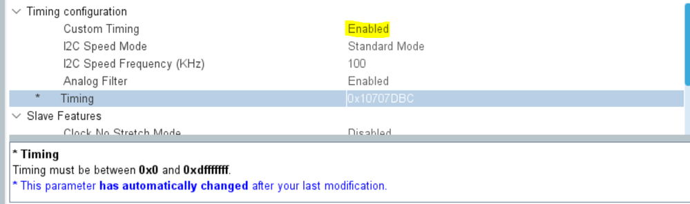

In STM32CubeMX (6.1.0) for STM32H7 the I2C parameter settings allow you to enable Custom Timing. However, the Timing parameter still remains disabled and cannot be set.
I would expect that for custom timing, the user could change the Timing parameter.

Hi @DOsbo​ ,
Thanks for your feedback and for the precision.
The issue can't be reproduced from my side: when enabling I2C Custom Timing for the first time, the Timing parameter changes automatically to be configurable (I've tested the behavior creating a project from scratch and also using the .ioc you've attached).
0693W000007CTvSQAW.pngTry please to use the latest STM32CubeMX version 6.1.1.

Thanks for replying. I've attached the IOC. I've discovered when changing the I2C custom timing for the very first time (from disable to enable), it doesn't enable the Timing parameter. However, if you then close and re-open the IOC file it is enable and it works correctly. For you to see the issue you will need to create a new IOC from scratch and then attempt to enable the I2C Custom Timing.
I'm not really concerned about the issue now that I know I just have to close and re-open the file to get it working.

Hi @DOsbo​ ,

Hi Khouloud,
I just tried it on a new IOC and you're right; it worked perfectly. I can't explain why it wasn't working before. The original IOC is quite old and has been through a few upgrades. Regardless, I am happy it is working now and sorry to waste your time.
