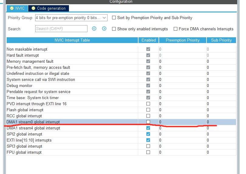

0693W000004IBAsQAO.pngI disable “DMA1 stream0 global interrupt�?,and then click Fiel-》save project ,then close STM32CubeMX。
But when I open the project next time, “DMA1 stream0 global interrupt�? is still enabled。
I do not know why? hwo can help me,think you�?

You are still using an old version (5.6.1) of CubeMX, which indeed had a bug here. Please upgrade to the most recent version of CubeMX to get your issue fixed.
Good luck!
/Peter

You could give us some more information: which device, which peripherals are used, especially which middleware you have enabled, etc.
Of course it stays enabled if there is anything using this interrupt.
/Peter
Good luck!
/Peter
