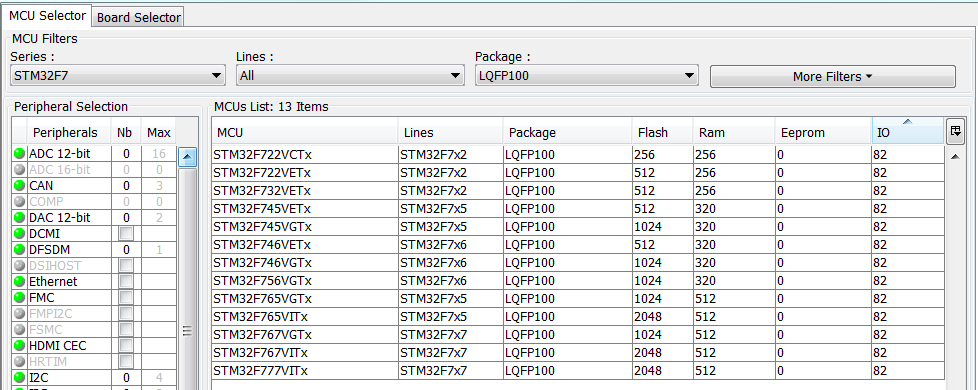

Hi All,
Are the 64pin versions of the stm32f7 chips in cubeMX?
I can find the 100 pin parts but not the 64 pin parts
Mark

Dear user,
Here are the supported STM32F7MCUs  in LQFP100 package in CubeMX 4.19 (out this week). This is aligned with the Datasheet. Can you confirm you find the MCU you need?

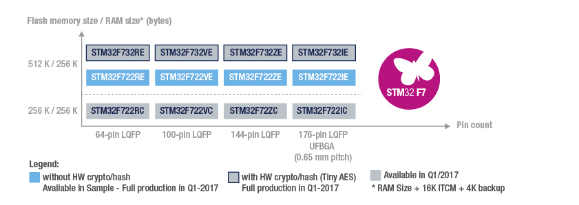

Hi
I'm looking for the 64 pin package.
Specifically, the STM32F723ZE as I think thats the only F7, 64 pin part at the moment

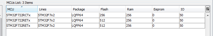

Hi Mark Skeete,
Please upgrade the CubeMX release to 4.19.
You will have 3 MCUs with 64 pin :
You can see them on ST website as well :

Posted on January 23, 2017 at 12:03
Thank you.
I updated a few days ago and saw them
