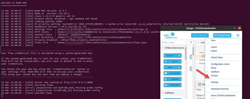

Hello everyone.
When setup a fresh setup with fresh Ubuntu 20.04 Desktop or Windows 10 Pro and fresh STM32 CubeMonitor 1.3.0 or even 1.4.0, the Manage Palette is not availabe at STM32 CubeMonitor Editor.
As workaround, install node-red with NPM and NodeJS according to NODE-RED website, fix this issue.
This is an expected behaviour or I'm missing something during STM32 CubeMonitor installation?

Hello @_acv_atr​
This behavior is the expected one, node.js needs to be installed first. Please have look to wiki

Hello @Richard.Chvr​
OK, thank you for your answer.
