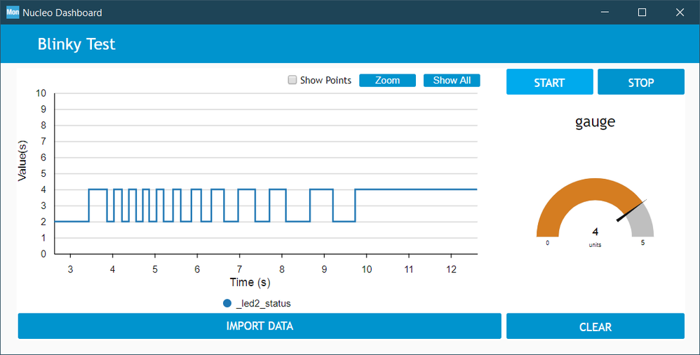

Made a simple "blinky monitor", and I'm impressed with the tool. I've previously used UART -> Serial plotter to plot my graphs. I will definitely use this tool in future projects.
Some things I'm missing (based on a few hours of experimentation):
- Seperate projects / project manager. I see a library option in the export view, but Ideally I'd like to just save and load the dashboard from my local disk. It seem like this opion is currently hidden under the "export/import" option, but save/open would make more sense to me as a user.
- An "open in browser" option. The dashboards can also be opened in a browser, but I need to check the wiki everytime to check which port I exactly need.
- A lanch from explorer option. If I want to share a dashboard with a colleage, the current workflow is: launch monitor -> export json -> share json -> lanch monitor -> import json -> deploy -> launch dashboard. Having a "launch" file changes this to: share lanch+json file -> double click launch file and the dashboard opens. In most cases my colleague would not be intersted in how the dashboard is developed, but simply wants to monitor the data coming in from the ST-Link. A launch file would make sharing dashboards much easier (and more user friendly).
- Option to remove the "Import data" on the STMicroelectronics chart node. Make this input a topic instead, so the user can add a button to import the data if desired. An option/topic to export visible and all data plotted in the chart would also be useful, as this makes logging of certain events easier. (I did notice a storage node, but if I understood that correctly, that seems to be a continuous write, which is not always needed)
- Better documentation. The wiki is very sparse in its documentation. A PDF with a simple walkthrough would be greatly appreciated.
- Better documentation of the impact on the microcontroller when using the monitor tool. The webnair mentioned that there is no impact, since it uses the debug interface, but stating that in your documentation would greatly be appreciated.
- WISIWYG dashboard development. This has low priority, but designing the dashboard is currently very much a guessing game and adjusting numbers and nodes until the desired layout is reached. A GUI drag-and-drop interface would speedup GUI development.
I'm looking forward to future updates. And @stephane.legargeant​ , kudus to the development team: this is indeed a useful tool.

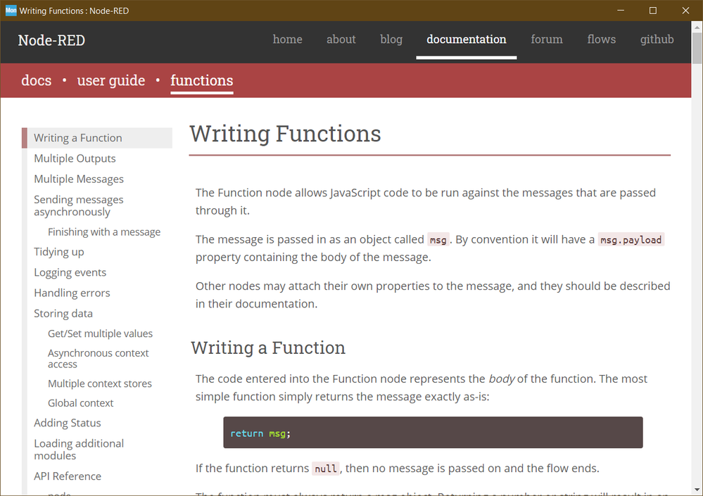

I may have come across a bug: I launched the documentation window by clicking on the "function" node => information => details => "online documentation" link. Whenever that's open, I am unable to launch the dashboard by clicking the "dashboard button.
‎2020-03-09 10:23 AM
Hello AShri.1
You are right, when the online help is open, the dashboard should be displayed, but it is not.
I can suggest 2 workaround :
- Close the help windows and then the dashboard will open.
- Open the tool inside Chrome ( http://127.0.0.1:1880/), and you will be able to open help and dashboard at the same time.
Best regards
Stephane
‎2020-03-09 10:33 AM
Thanks a lot for the feedback, it is very interesting for us.
Some answers to your points :
- For the "open in browser", I have added a bookmark in my browser, you can also create a shortcut.
- For the WISIWYG, there is a layout editor for the dashboard. It is accessible in the dashboard tab, in the Tabs & Link area :
- We plan to add new pages in the wiki, and we will study the other points.
Best regards
Stephane
