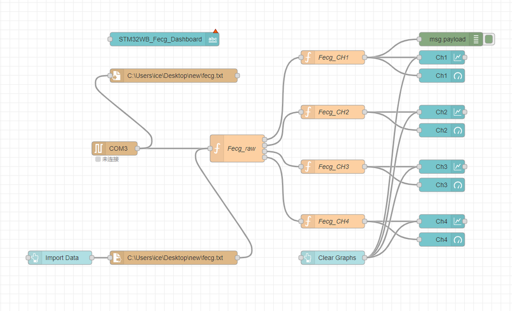

I want to use STM32cubemonitor to receive serial port data, the serial port data is four channels. And draw the four-channel data.
I can't find any relevant examples and don't know the implementation to split the data ...

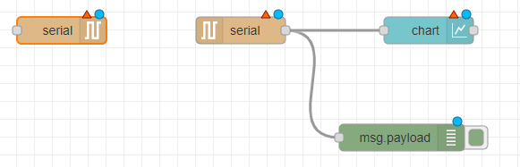

I don't know how the data of your 4 channels are represented in the payload ?
If you are able to change this representation on your serial interface side, one of the easiest ways is to format your data in csv.
After that, you can use a csv node to split each data in a message.

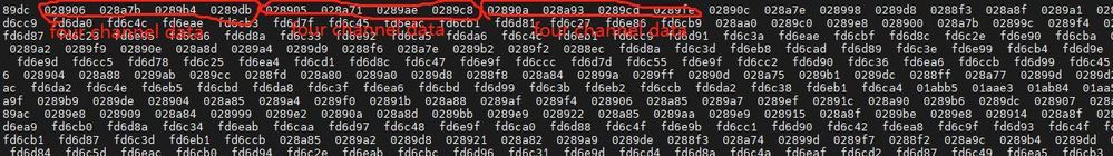

I am collecting external ADC data, and then inputting it through serial port. 24bits is one channel data, every four is a group(as figure shows). I want to chart the data for each channel, and have the four channels simultaneously do the waveform drawing in real time.
Do you have any relevant examples?

Sorry, I do not have any ready-made example.
I can advise you to use a function node, loop through the elements, store each group into a temporary array, convert the array in JSON format.

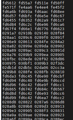

I've been watching javascript and node_red tutorials all afternoon, and I'm pretty new to the programming that functions require....so I'm still out of ideas. I changed the serial port input to the form shown in the figure below. The four values ​​in each line represent the data of four channels. Then I can use the chart to make dynamic waveforms. Can you be more detailed?
RomainR.
Hello @Lep (Community Member)
Here attached a very basic flow. The serial data are split with space character \0x20 (because it is the format of your use case)
Then using batch (by 4 elements) and join (into array) node you can send it to csv formater node.
The result is in the debug console in the right.
Here the serial is configured as 115200, 8, 1, n.
Best regards,
Romain

it is probably not the best methods, but it can be a starting point for you.
Thanks again for your help.
Recently, I learned javascript and node red once, and I have basically completed my functions. You have given me a good start to face these problems.
