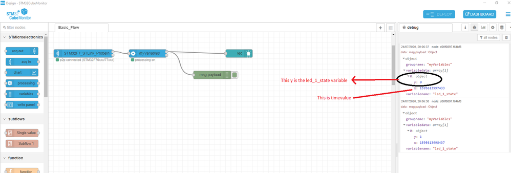

I just found this software STM32CubeMonitor and as a starting point I started with a simple LED Blink Example.
In my example there are two variables "led_green_state" and "led_red_state" and the value of these variables changes over a period of time.
I thought to create a dashboard but I am not able to do so.
I didn't find any node which can represent the led on off states on the dashboard.
In order to get familiar with this software do I have to understand about the Node-Red, since CubeMonitor is based on this.
Although the project works with the charts, as I am able to plot these two variables on the chart, but I need to blink leds on the dashboard. Is it possible?

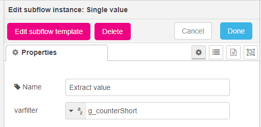

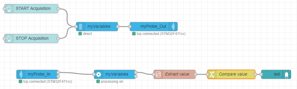

To switch the led color, you must send a msg with a specific payload. By default, the ui_led will turn to green when boolean value true is received, and to red when false is received.
The subflow "Single Value" in the palette will help you to parse the data : it will extract the value you want to monitor.
Here is an example :
In this example, the Led will monitor the value of variable "g_counterShort".
- first in the "Single Value" subflow, I set "varfilter" to "g_counterShort" The node will extract the value from processing node message and send only the y value in payload.

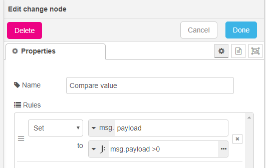

- Then a "change" node is used to compare the values.
The "change" node will send "true" is value is above 0, else it will send "false". You can customize the condition for your need.
