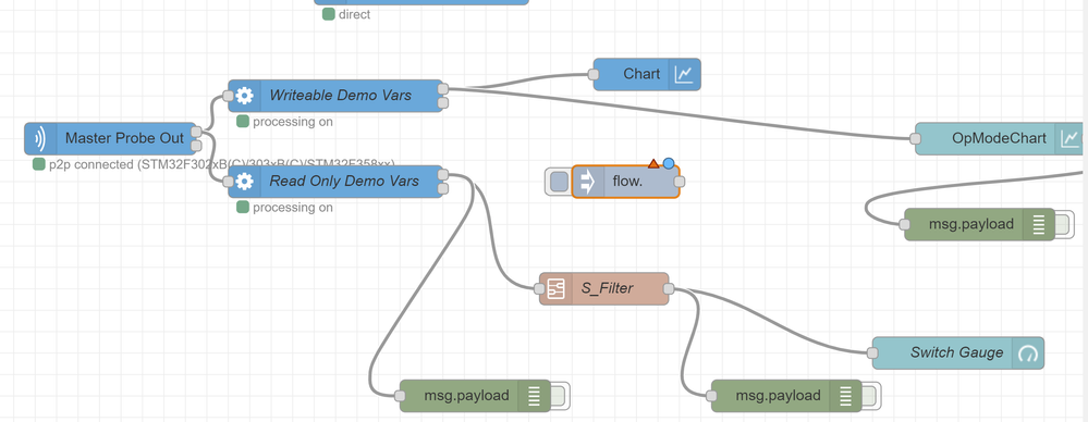

AGamb.2
Hi @Richard.Chvr​ ,
Thanks for replying quickly. I understand that the ST chart has Ymin and Ymax available only for the Bar Chart. That is why I want to avoid it all together and use the Chart Node that comes with NodeRed. This chart does support Ymin and Ymax for a regular chart. But it doesn't seem to work the ST processing node like the ST chart. I want to know how to make this chart work with the ST processing node so I can stop autoscaling

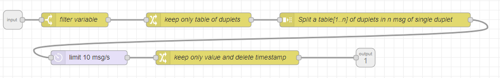

I don't know exactly what data format is expected by NodeRed Chart. You have to know the ST chart expect json formatted data as payload input ( see input section of chart help for more info).
You'll probably need some processing in order to input those data to NodeRed chart. Maybe be single value sub-flow could help to start:

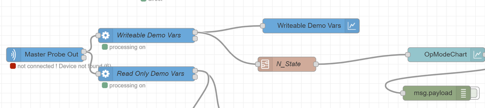

AGamb.2
Hi @Richard.Chvr​
I tried the single flow into the NodeRed Chart and it did not work.
Curiously when I connect to the ST chart it also doesn't work. This seems like a deeper subflow issue so I've attached the flow. 0693W000003PCoUQAW.png
Richard.Chvr
ST chart is not supposed to work as output of the single value sub-flow, only gauge does.
I proposed you, single flow, in order to give you some hints to develop your own subflow and allow you to get Ymin and Ymax values.
