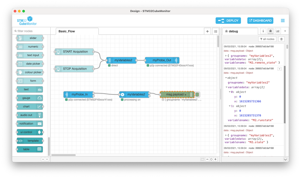

Hi, I need to monitor variables from my program in CubeMonitor. I was able to follow a few videos from Youtube and set up the values in a chart. However, that is a very clunky interface. Please note that I have zero experience with nodered.

What is your problem? I am using CubeMonitor to graph several variables from my program. Maybe I can help if you can tell me specifically what is going wrong? Have you looked at the Monitor wiki?

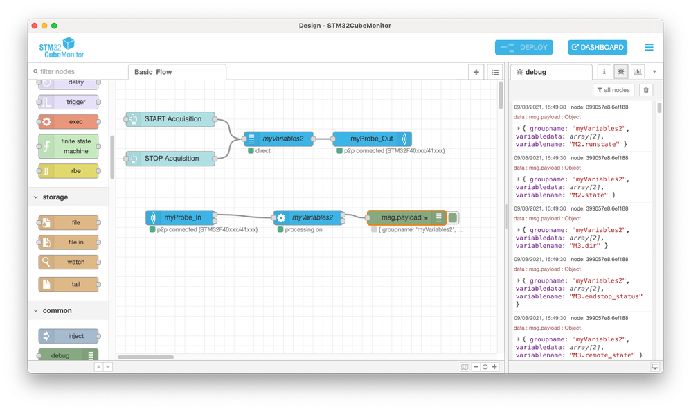

Thank you and yes I did see the wiki. However, it only talks about listing data in a graph/chart. There is nothing there about writing it to other formats such as tables (which was possible with STM-Studio). I had posted his query on the node-red forum too and they suggested adding a debug node to see what data is being shown. Those screens are shown below. I do not how to channel this data to a table where the variables are rows and the column contains the value.

I was hoping you were having problems charting. That is easy. Everything else is hard...or maybe impossible.
Over the last 24 hours I have spent a lot of time trying to get my data to a CSV file. My problem is very similar to your problem. I have two variables and I want those two variables in the file.... var1, var2 LF.
Frankly, I am not sure it is possible. The messages from the MyVariables block is quite complex. And the data for each variable is in a separate message. I’m not sure it is possible to join the two messages into a single message. This needs to be done before both variables can be put into a CSV file.
It appears that the message structure is complex enough that ST had to creat a chartst node to be able to graph this data.
Here is something that might help. Look at the chart node...the one written by ST. The documentation on it is quite good. They explain the data format it is expecting. That is the format of the data coming from the processing node. Once you understand the format of the data, you might. E able to write a function to transfer the data from a particular message to the correct row of your chart.
