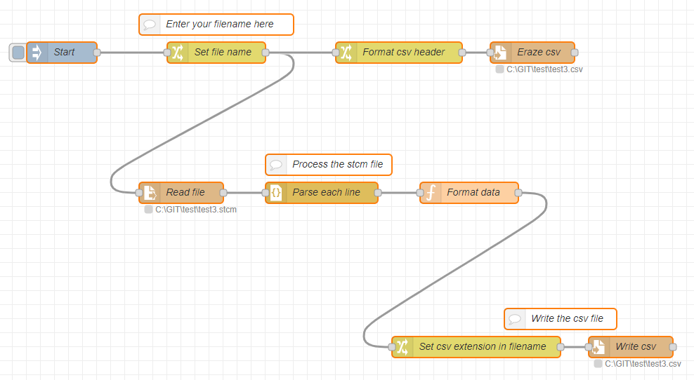

How can I to store variables into a csv log file?
  • June 18, 2020
  • 7 replies
  • 4600 views
I see file storage saves a json. I tried to put a csv conversion node in the middle but nothing is saved.
Thanks
Best answer by stephane.legargeant
Hello
The .stcm may not be processed properly by the node-red-contrib-json2csv because it is a list of json blocks. So each block should be parsed separately.
Here is a proposal to convert the stcm files in csv. It will output on each line of the csv file the variable name, x and y.
Here is the flow to import :
[{"id":"cc0c8ae8.c69f98","type":"tab","label":"Convert stcm","disabled":false,"info":"This flow is used to convert stcm file in csv file\n\nThe file name must be entered in the \"set file name\" node\n\nThe csv output format is variable Name, x, y\nNote : the data may be processed by group, so the x value may not be in time order. The csv file may be sorted on the x value to ensure order coherency. "},{"id":"a9caceb2.eb94d","type":"file in","z":"cc0c8ae8.c69f98","name":"Read file","filename":"","format":"lines","chunk":false,"sendError":false,"encoding":"none","x":280,"y":360,"wires":[["99d027a1.b92d98"]]},{"id":"9350e2b8.9aa3e","type":"inject","z":"cc0c8ae8.c69f98","name":"Start","topic":"","payload":"","payloadType":"date","repeat":"","crontab":"","once":false,"onceDelay":0.1,"x":110,"y":160,"wires":[["3371f5e6.b3b50a"]]},{"id":"99d027a1.b92d98","type":"json","z":"cc0c8ae8.c69f98","name":"Parse each line","property":"payload","action":"","pretty":false,"x":480,"y":360,"wires":[["badf8efa.bacee"]]},{"id":"badf8efa.bacee","type":"function","z":"cc0c8ae8.c69f98","name":"Format data","func":"let output=\"\";\nmsg.payload.variabledata.forEach (data=>output=output+ msg.payload.variablename+ \",\"+ data.x + \",\"+ data.y+\"\\n\");\nmsg.payload= output;\nreturn msg;","outputs":1,"noerr":0,"x":690,"y":360,"wires":[["38fb106e.c00f"]]},{"id":"d2859af6.e93368","type":"file","z":"cc0c8ae8.c69f98","name":"Write csv","filename":"","appendNewline":false,"createDir":false,"overwriteFile":"false","encoding":"none","x":920,"y":580,"wires":[[]]},{"id":"3371f5e6.b3b50a","type":"change","z":"cc0c8ae8.c69f98","name":"Set file name","rules":[{"t":"set","p":"filename","pt":"msg","to":"C:\\GIT\\test\\test3.stcm","tot":"str"}],"action":"","property":"","from":"","to":"","reg":false,"x":330,"y":160,"wires":[["a9caceb2.eb94d","593d0b11.8d3654"]]},{"id":"f3d3a57a.c56e48","type":"comment","z":"cc0c8ae8.c69f98","name":"Enter your filename here","info":"","x":330,"y":120,"wires":[]},{"id":"38fb106e.c00f","type":"change","z":"cc0c8ae8.c69f98","name":"Set csv extension in filename","rules":[{"t":"change","p":"filename","pt":"msg","from":"stcm","fromt":"str","to":"csv","tot":"str"}],"action":"","property":"","from":"","to":"","reg":false,"x":700,"y":580,"wires":[["d2859af6.e93368"]]},{"id":"b1ba9fe.177b06","type":"file","z":"cc0c8ae8.c69f98","name":"Eraze csv","filename":"","appendNewline":true,"createDir":false,"overwriteFile":"true","encoding":"none","x":780,"y":160,"wires":[[]]},{"id":"593d0b11.8d3654","type":"change","z":"cc0c8ae8.c69f98","name":"Format csv header ","rules":[{"t":"change","p":"filename","pt":"msg","from":"stcm","fromt":"str","to":"csv","tot":"str"},{"t":"set","p":"payload","pt":"msg","to":"Variable, x, y","tot":"str"}],"action":"","property":"","from":"","to":"","reg":false,"x":590,"y":160,"wires":[["b1ba9fe.177b06"]]},{"id":"796c6b18.2aab34","type":"comment","z":"cc0c8ae8.c69f98","name":"Process the stcm file","info":"","x":490,"y":320,"wires":[]},{"id":"c2ec88a.7368678","type":"comment","z":"cc0c8ae8.c69f98","name":"Write the csv file","info":"","x":820,"y":540,"wires":[]}]
To use it, go to menu import , copy paste the text, and select "new flow".
Then for each conversion :
1) in the box "Set file name", enter the name of file to convert (absolute path + extension : "C:\log\test1.stcm")
2) press start. The file will be processed and stored with the csv extension.
I hope it will answer your need.
Stephane

Dear @Franco Spediacci​ ,
Can you share your flow to try to understand your issue ?
Landry
Franco Spediacci
June 23, 2020
Hi Landry,
thanks for reply.
You can find two flows attached and related logs.
In one I do not use conversion. In the log I see json.
In the other I use CSV conversion. In the log I see only the variables names.
Franco

Hello
Stephane
FDi L.228
August 12, 2020
It works, thank you!
