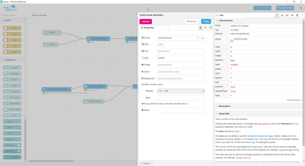

I don't have the exapmle configuration anymore, so I started my own configuration. For example, how do I get start the data aquisition?
I configured the Probs and variable files as described on the Youtube video, but after the "Deploy" button and the "Dashboard", the Graph is very small and the Start/Stop Button has no effect.
Therefor, I thought an introduction manaul, how to configure each node for a basic configuration would be helpfull.
Or how do I get the "Basic_Flow" configuration back?

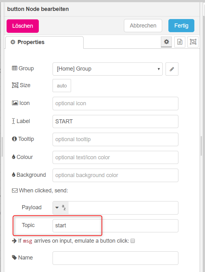

‎2020-10-14 07:39 AM
now it works :) Thank you very much.
I forgot the keyword "start"/"stop"/"clear" in the topic-field. Is there are list with all "topic"-Keywords?

You can find information in the help of each node .
For acq out
topic
The topic possible values are
- read to send a command of one shot read
- start to send a command to START acquisition
- stop to send a command to STOP acquisition
payload
The payload is an object representing the variables group configuration defined in the variables node. The payload object holds several properties summarizing what have been set in the configuration panel of the variables node.

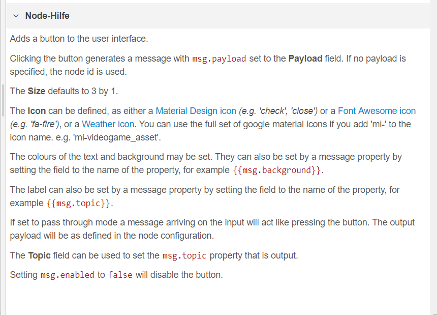

I have some more questions:
- In the Help for each Node is only the Keyword {{msg.topic}} is displayed. There is no information about what it can be. Is there a list of keywords?

1 - your are looking for the help of the standard button ( not specific to CubeMonitor ) , to know the list of inputs you have to look at the following nodes which will use this topic ( for example acq out node )
