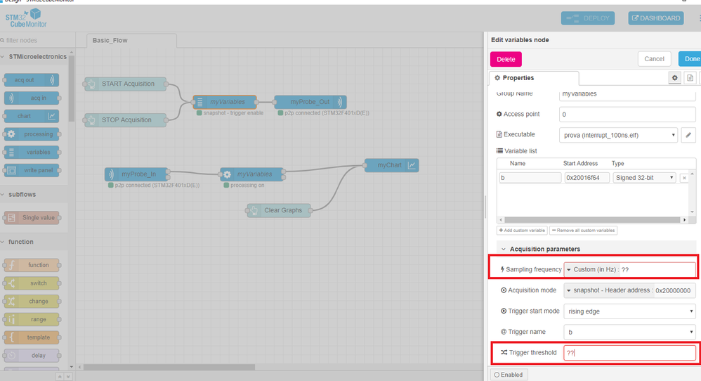

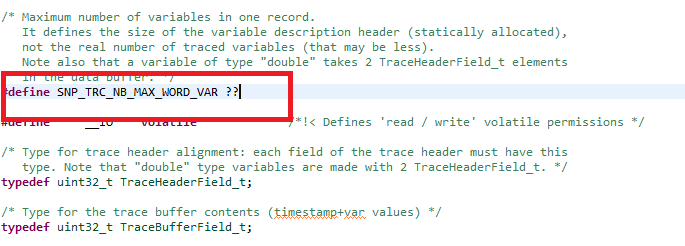

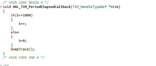

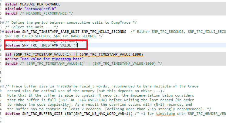

hi, my goal is to verify a variable named "b" which is increased up to 1000 and then reset to zero, the increase takes place via an interrupt that is generated every 100 ns and check on CubeMonitor in snapshot mode the value of the variable.0693W000000W67RQAS.png Inside the installation folder of the CubeMonitor program I found the dataAcq.c and dataAcq.h files. Inside the dataAcq.c file I found that I had to set SNP_TRC_TIMESTAMP_VALUE (with a value between 1 and 1000) and did not modify NP_TRC_BUFFER_SIZE (50 * (SNP_TRC_NB_MAX_WORD_VAR + 1)).0693W000000W66xQAC.png in the dataAcq.h SNP_TRC_NORD_ORD_MAX_ORD_MAR_MAX file.
how should these values be determined? In CubeMonitor I found other values to set in the variable medu (sampling frequenty, trigger treshord). how can i determine these values?0693W000000W67HQAS.png

I need to understand how to set SNP_TRC_BUFFER_SIZE in order to display 100 points on the STM STUDIO, setting the quantity of variables to 9 (SNP_TRC_NB_MAX_WORD_VAR = 9). In STM STUDIO I set the Start in (Manual) and the Stop (when buffer full). if I set SNP_TRC_BUFFER_SIZE (10 * (SNP_TRC_NB_MAX_WORD_VAR + 1)) I don't find myself in STM STUDIO 100 points but I find myself with 32 points. How can I get 100 points, how should the variables be set.
